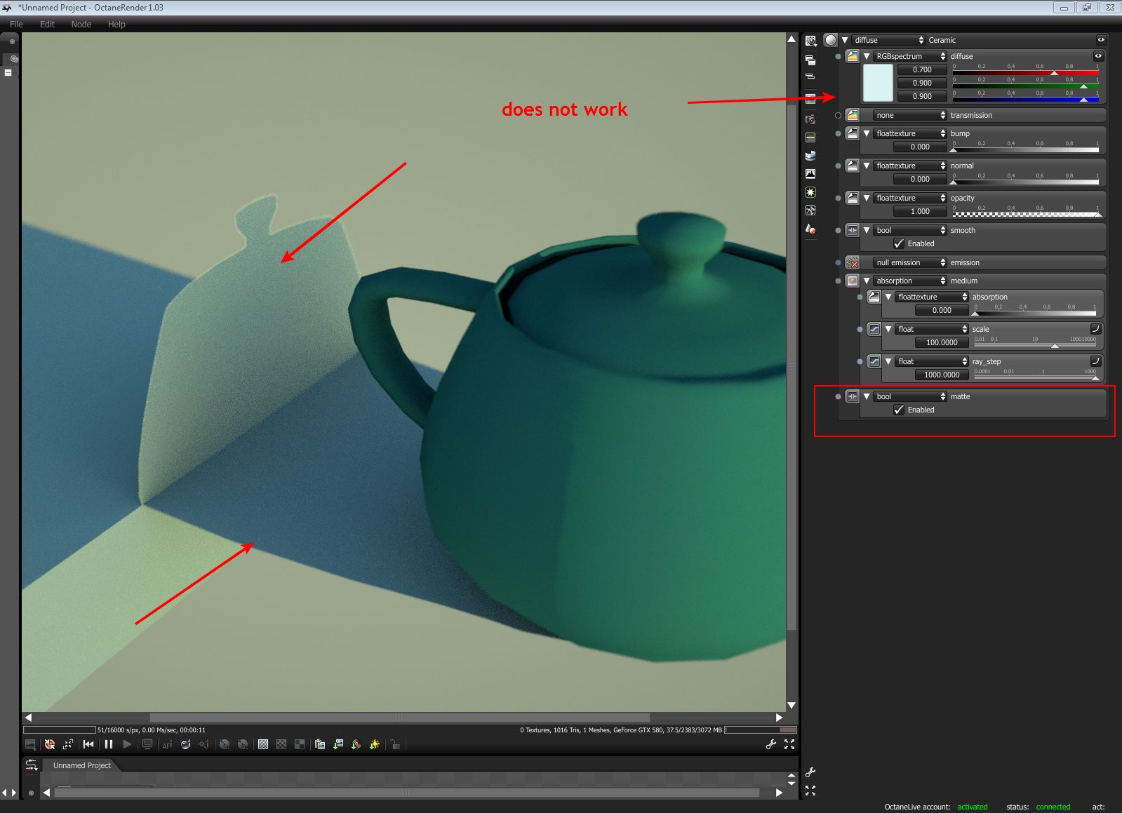

does not work

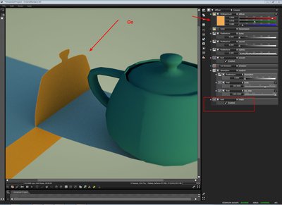

New feature : Shadow Catcher
Shadow catcher by Karba
Should look like this
Karba
Posts: 2300
Elvissuperstar007 wrote:New feature : Shadow Catcher
Set diffuse color to black

I'm getting a similar result that Elvis is getting. I have the alpha channel turned on in the kernel and keep environment is turned off. Setting the diffuse color to black didn't make any difference?

Ah, I see it doesn't work with the day light system.
