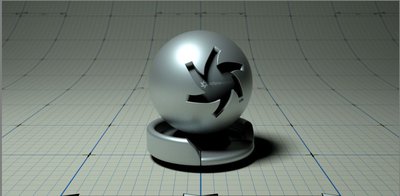

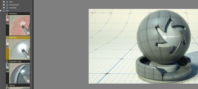

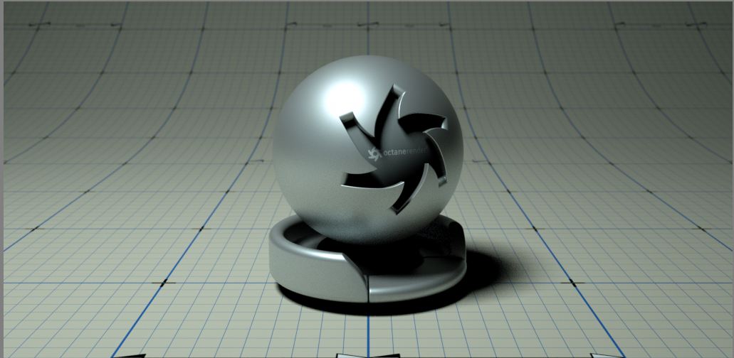

I am sure I must be missing something but when I try to choose some materials in the LiveDB the preview is very different from what shows up the render window. I notice this particularly with the silvery metal materials. No matter in texture environment or daylight I cant get the material to match. Here are some examples. I am using the 1.1 release.
And there is no Chrome material in the DB? I would think this would be one of the most popular materials.

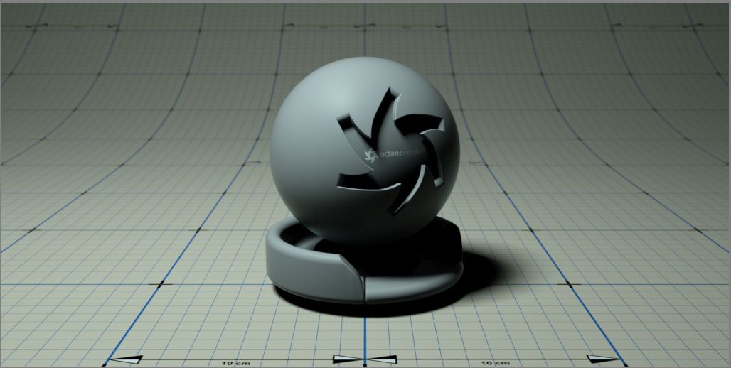

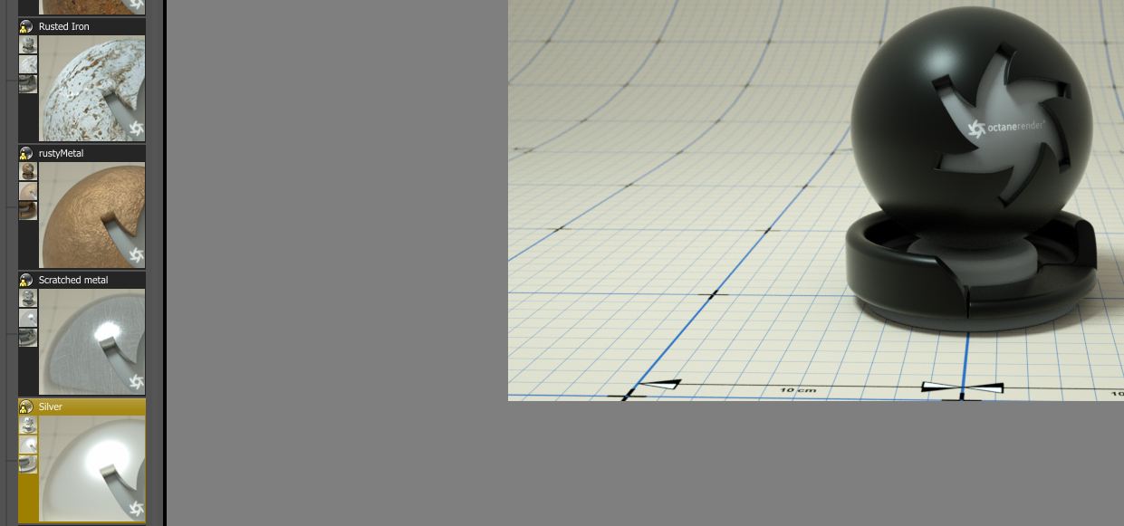

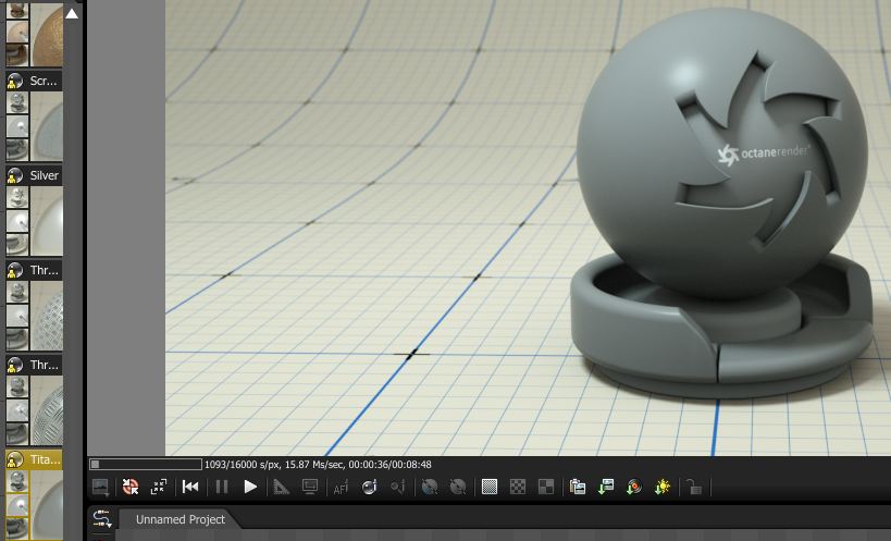

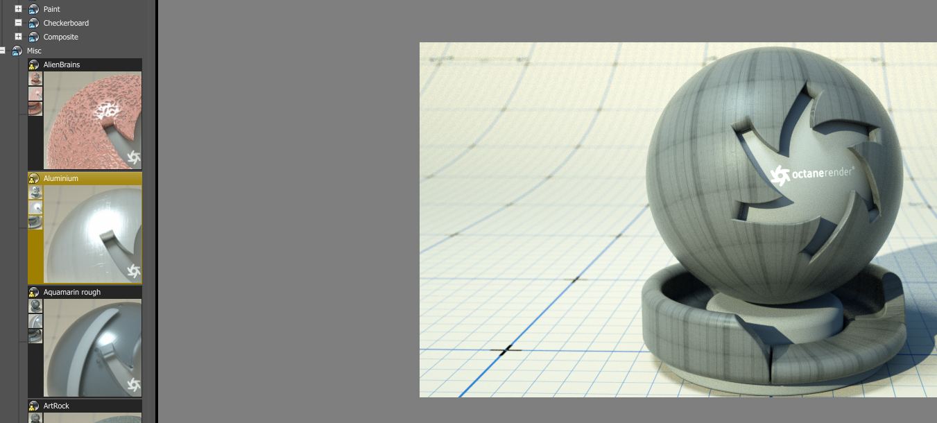

If I choose Aluminum from LiveDB, then choose it with the Material Picking tool this is what I see.

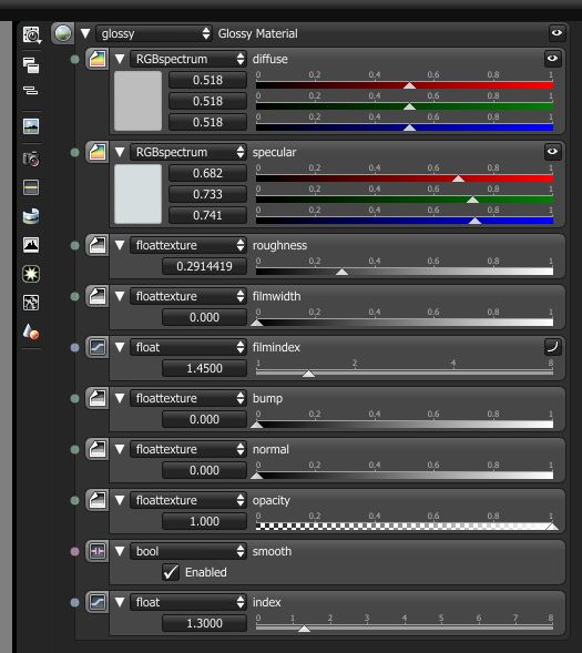

If you mean the "Index" Slider then yes I get this in my bottom photo. No to be obtuse but if anyone is new to this I just want to be sure I am choosing the correct slider and not missing a Fresnal Slider somewhere

That's correct, Buzby, It's the index slider. Sorry for typing the fresnel slider :oops:
