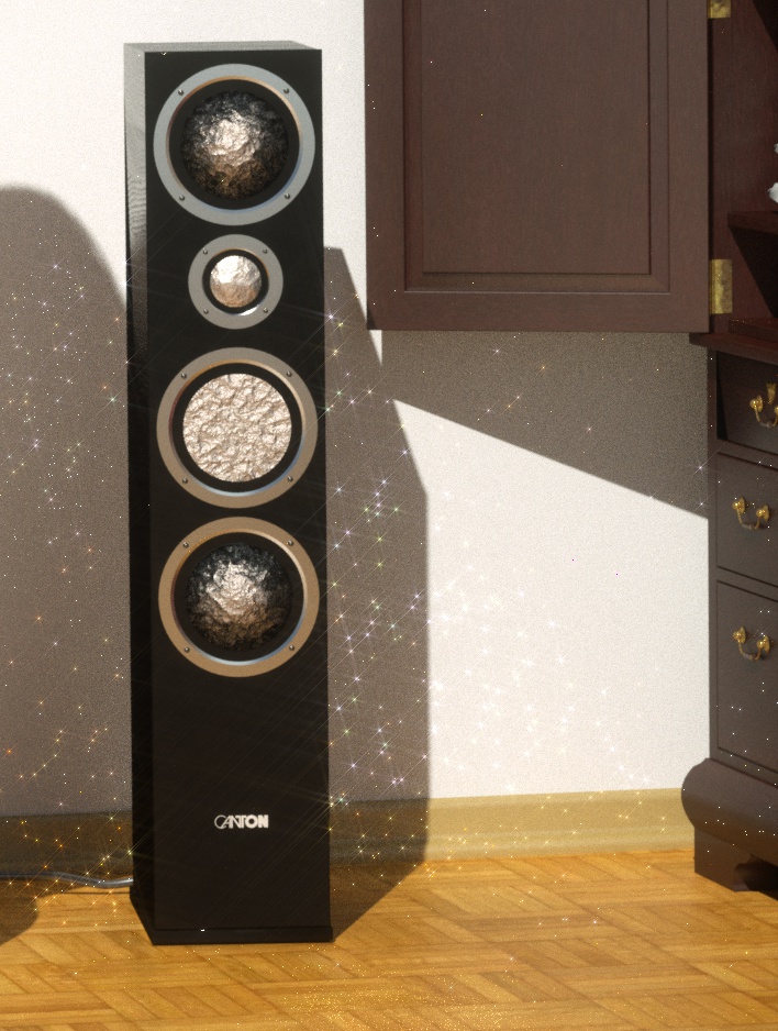

Instant Christmas! (Glare = 3) ;) ;) ;)
I like it! Thank you very much.
