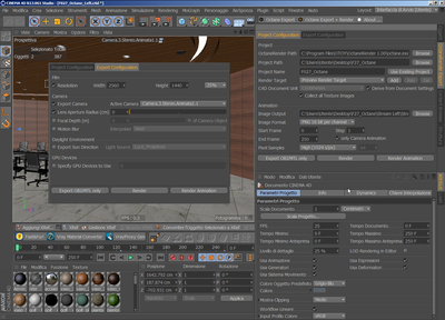

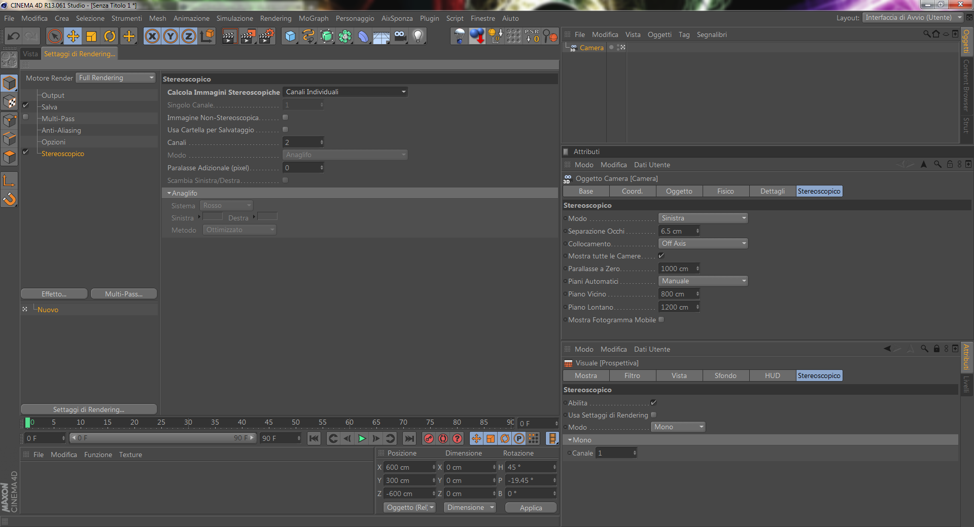

I tried 2 ways:
1) no stereo config in rendering setup; viewport configured in stereo mode mono (switching between channel 0 and 1 each time I render); camera 3d (switching between channel 0 and 1 each time I render) left mode ON;
2) the same configuration of 1) + stereo rendering setup, exporting separated channels (matching the camera channels)
Every time it renders the same camera... please, see the attached file.
Andrea Mannori
win 8.1 x64; nvidia 770M driver 340.52; octane standalone 2 + c4doctane 2.

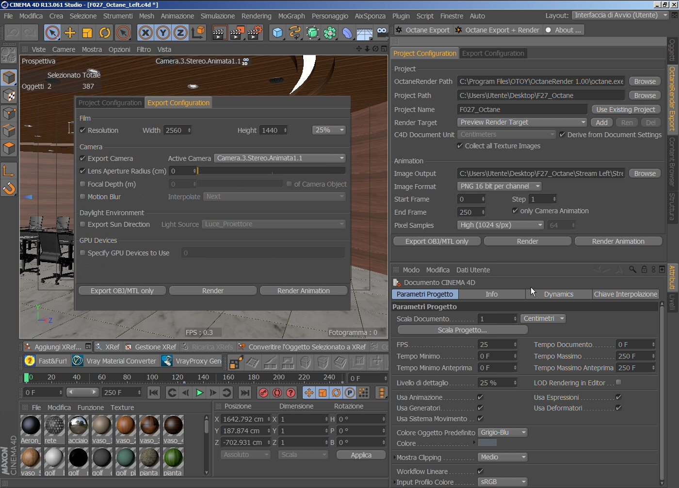

What was your setup in the exporter?

these are the settings of Octane plugin

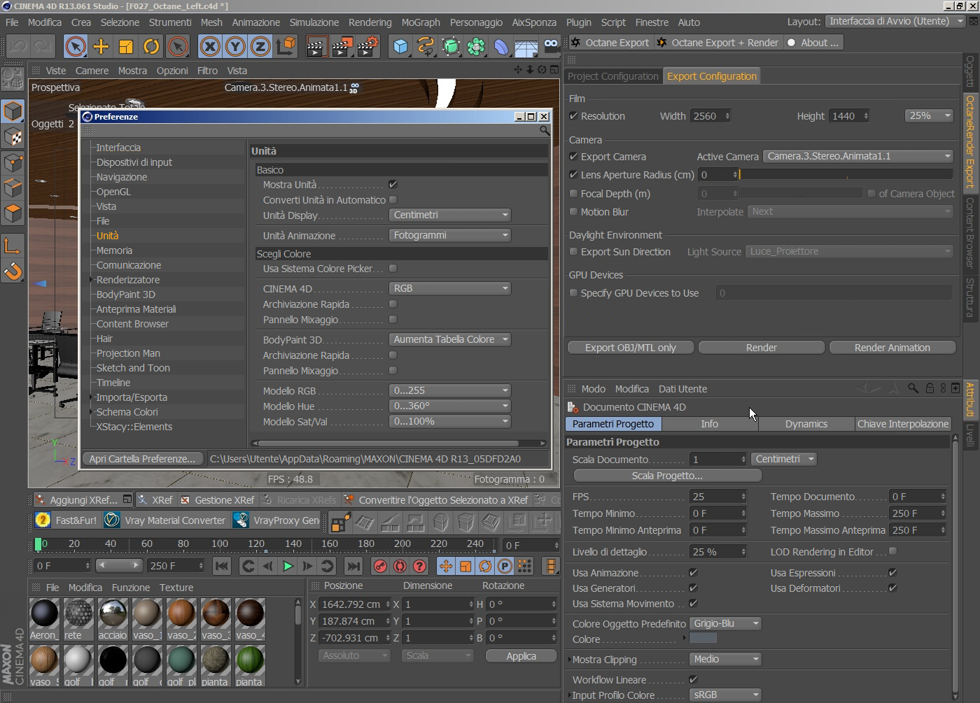

Maybe a problem related to the Units settings? (cm - cm)

renderfarmsrl wrote:Maybe a problem related to the Units settings? (cm - cm)
How big is your scene, the distance between cameras, the document unit, the unit chosen in the exporter and the unit chosen in Octane in the import settings?
