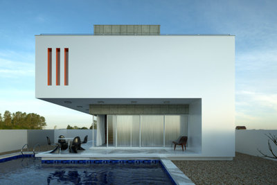

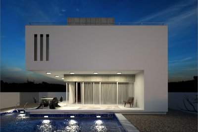

Previews of a project I'm working in.
here's my thoughts :
I'd be tempted to do the dusk version in two renders, one with the blue HDRI, and no emitters and then another one with a black environment, and the emitters
then comp these in photoshop - add the 'lighting' render as a 'screen' or 'linear dodge (add)' layer over the top..
just gives more flexibility, you can add further colour to the 'lighting' layer, duplicate it to really boost the lighting...
and then composition wise, I'd also be tempted to have more on the left, showing the full pool? And then those twigs on the right, I'd move them over
if possible, as you might as well have more of them rather than the little amount you show now?
and maybe more sky at top?
again, just my thoughts...

Thanks sdwhitton,
I'll try your suggestions on the next render.
