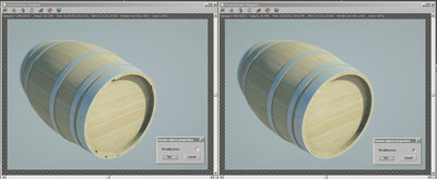

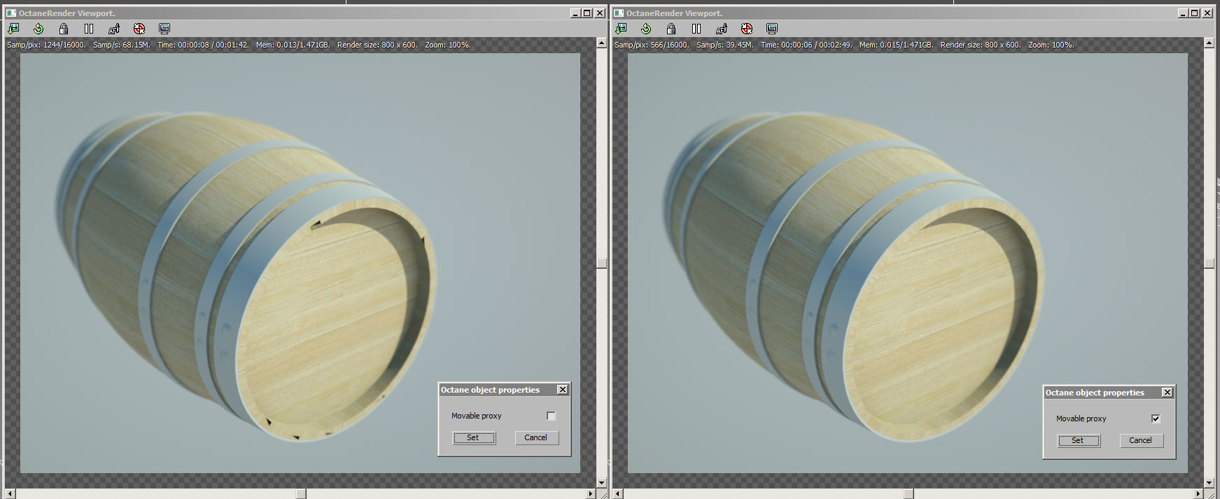

Strange thing : when movable proxy is off some faces seems to turn black.
bicket
Posts: 365
Joined: Thu Mar 01, 2012 10:46 am
If you check proxy while octane is rendering, your object will be loaded 2 times:
- as a "standard" object when you hit start the rendering
- as a proxy when you check it as a proxy
try to reload the scene
PortFolio
4 x TITAN - Win 7 64 - Octane Rocks
HHbomb
Posts: 1438
bicket, when I check "movable proxy" then, I reload the scene, same, when I uncheck, I reload the scene.

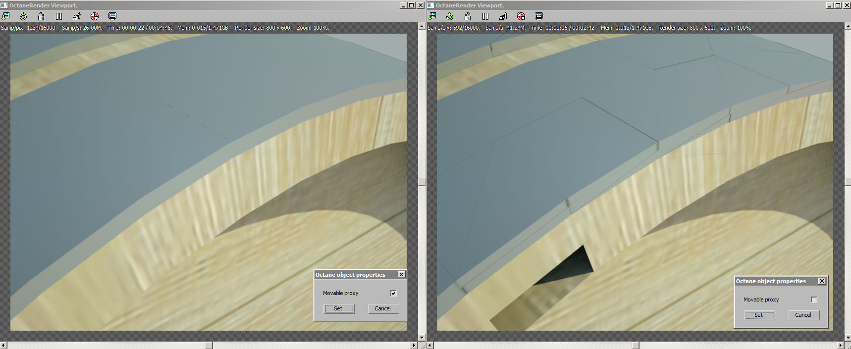

here is a close up...
roeland
Posts: 1826
This can happen if a small object is placed far from the origin. The next release will suffer less from this issue.
Roeland
HHbomb
Posts: 1438
thanks for answer.
But this object is 1 meter long, and located at Z=436 m...
Not so far (?)
Could you give us some idea of "limits" when using octane because I have always "big" models..
