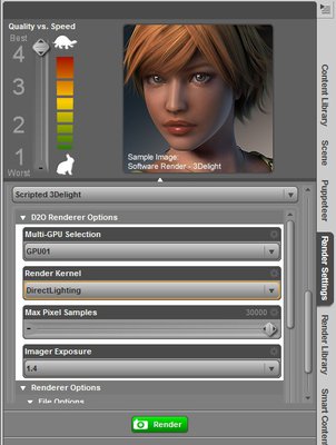

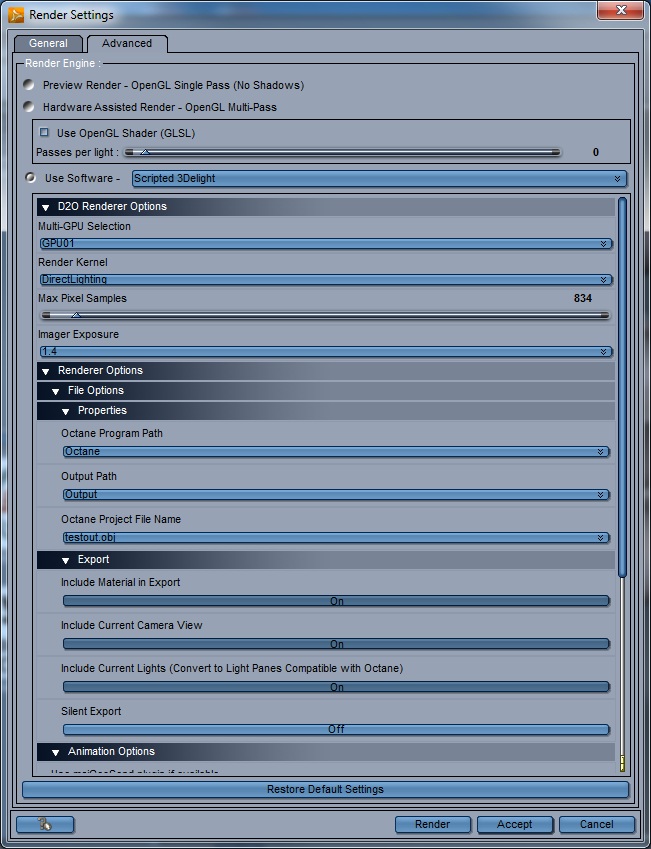

Sneak peek.
Render options will be available using Shift+Ctl+R to access the menu options
To render in Octane simply Ctl+R
For Animation you have to set in render option and if you do not select image sequence, the plugin will automatically prompt you for codec and create your movie instead of image sequence you could further edit.
Integrated D2O screen shot
DS4.5 D2O screen shot
