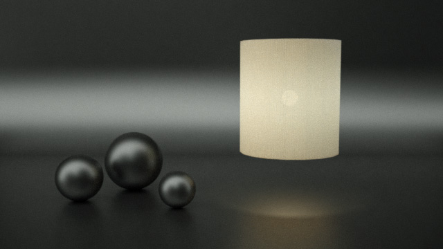

petergazo
Posts: 32
Joined: Thu Dec 01, 2011 12:13 am
Location: Bratislava, Slovakia
my first time with standalone. HDR from Jeff Pattons site http://jeffpatton.net/2012/07/iray-studio-scene-2/.
Lamp_ocs.zip
(2.63 MiB) Downloaded 253 times
i5-2500k | 16GB ram | gtx460 2GB (display) + GTX580 1.5GB | Win7 pro x64 | v1.0 beta 3.00b | http://www.behance.net/petergazo

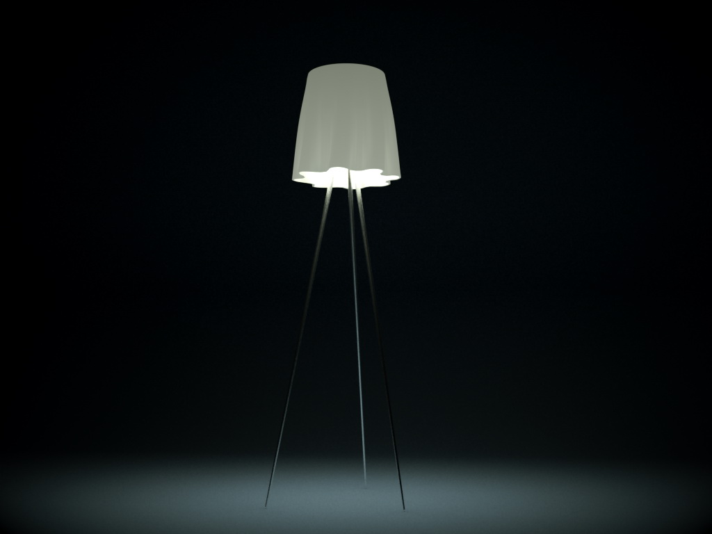

acc24ex
Posts: 1481
Joined: Fri Mar 19, 2010 10:58 pm
Location: Croatia
I think I got success on that by using some SSS in the end.. but you need to add secondary invisible light sources since it won't light up the room, just for show
here's something
http://render.otoy.com/forum/viewtopic. ... ade#p91809
http://render.otoy.com/forum/viewtopic. ... lamp+shade
I did the render in octane in versions without SSS, emmiter was assigned to the lampshade and then turned down until it looked OK, then secondary light plane placed below to light up the bottom and probably a light sphere inside

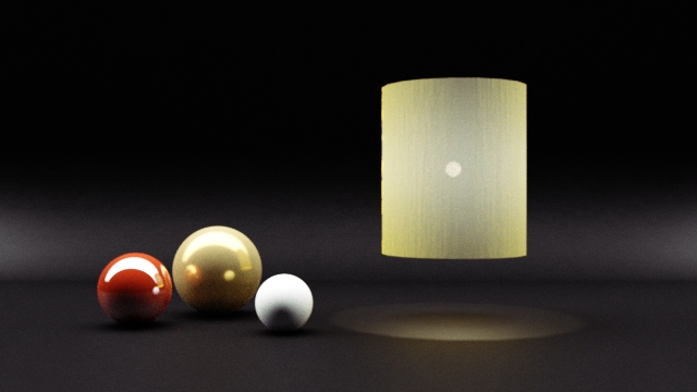

octanetry
Posts: 50
Joined: Thu May 31, 2012 9:04 pm
I did this test by adding texture to the bump and the material.
The texture is not suited for purpose but give a bit of realism to the fabric that otherwise would be flat
1with texture.jpg (28.12 KiB) Viewed 5474 times
