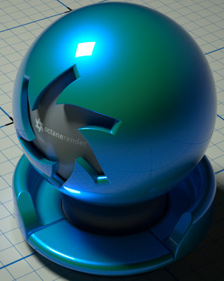

Evermotion car model. Just adopted it to Octane with 3dsmax material convertor.
tonycho
Posts: 391
Joined: Mon Jun 07, 2010 3:03 am
Location: Surabaya - Indonesia
Hi Karba. great car paint :)
can you give us the setting for material please :)

marcio_max
Posts: 132
Joined: Mon Dec 05, 2011 12:17 pm
Location: Aracatuba/SP/Brazil
Spectacular! :o

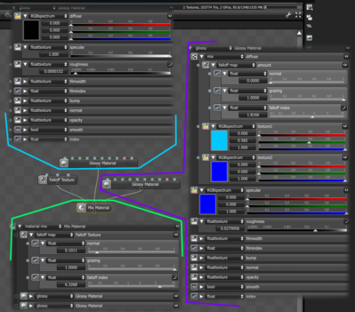

Karba
Posts: 2300
Here is the settings

Would you add that one to the Live DB please. :D
Its a handy material to have and a good example of the use of falloff.
