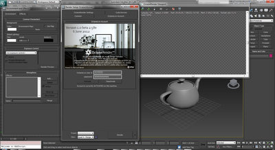

Hello Octane guy :O
I just try one simple scene with only teapot model and 1 octane light and using an Octane camera and I can not see anything...
I also try to change environment color to white... not work
I have read about the issue of kepler card and install the correct build already .
My Standalone work fine but the plugin version for this build is still not working...
I included a screen shot also..
Do I need some thing more in the setup process ?

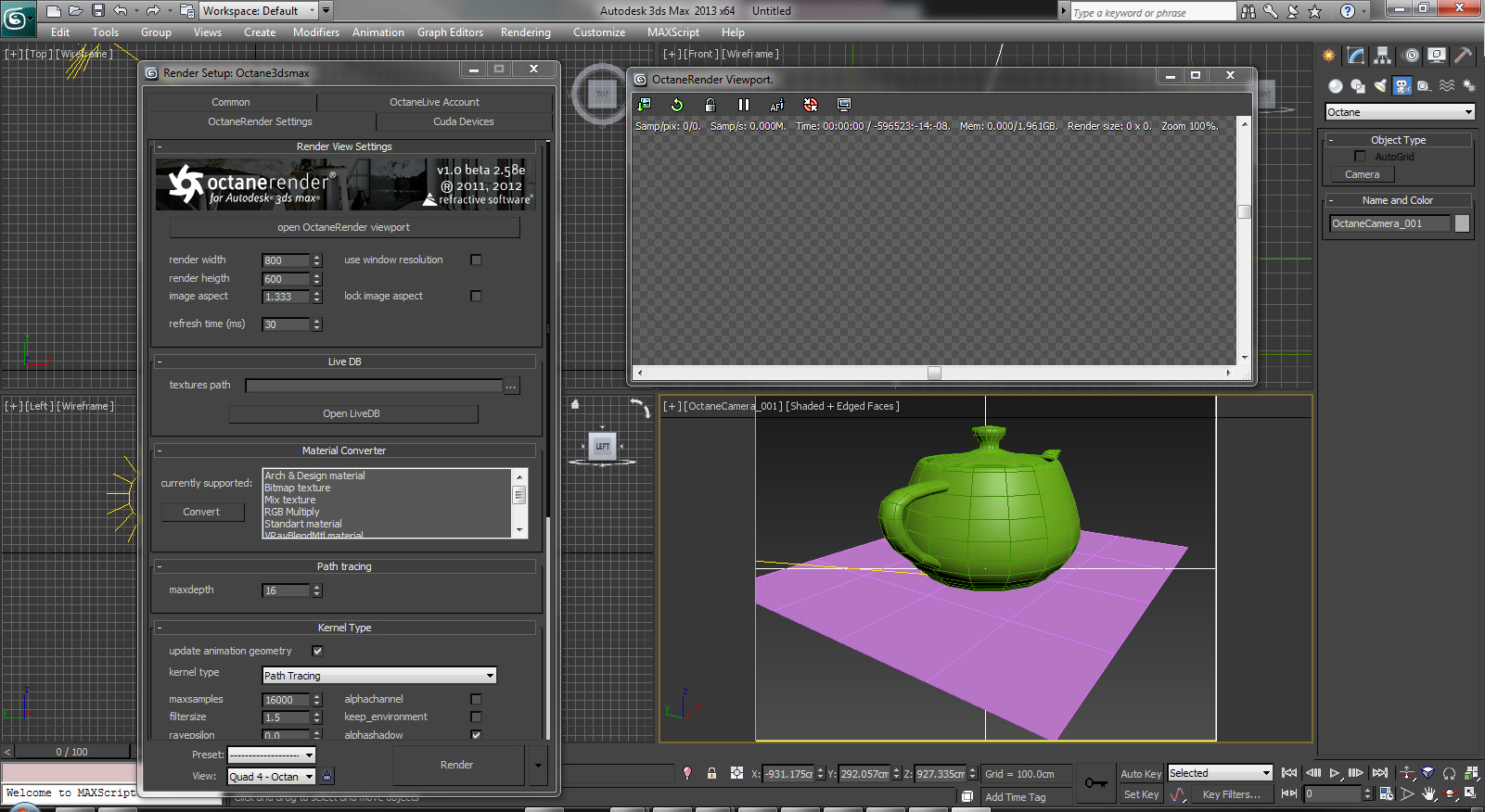

It is activated...
as the screen I attached for you I have use a 30 days trial of nPower PowerTranslater for importing a nurb to MAX . Its not expire yet but I wonder if this plugin will have any effect for Octane?
But my simple test is not using any feature for nurb at all it's just standard MAX model...
I confirmed that the Standalone build is working fine... Most of my job is done with vray but I decide to go with Octane after I see a very nice speed and very easy to setup a material...
But I cant do job in a standalone app because I need a very interactive way to test and changing material and/or a model in the scene so integrated plugin is the best choice for me...
Do you have any suggestion for me?
NIRUT

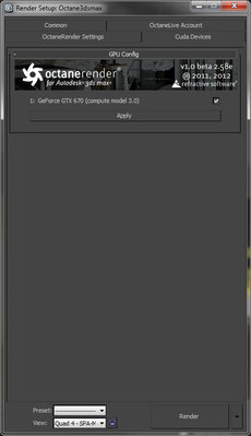

Can you show your cuda devices tab?A2Zen wrote:It is activated...
NIRUT

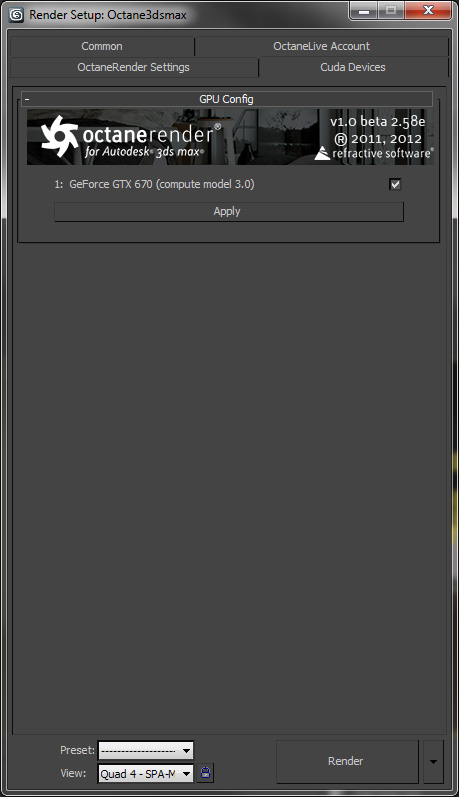

Here is the CUDA Device tab...
I have 2 VGA cards installed
-ATI radeon HD4850 for my main display
-Geforce GTX 670 only for CUDA
I use Nitrous display mode for 3dsMAX
When I use VRay RT this GTX670 works fine both OpenCL or CUDA engine
I dont know why I cant use the 3dsMAX plugin for Octane...
Now I'm just working with VRay RT...
I hope I can use Octane normally like other people
NIRUT
