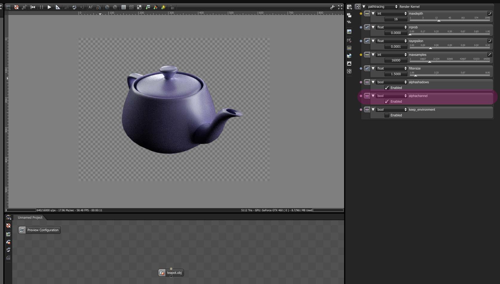

probably best to use the hdri background to light the scene with alpha channel switched off.tomassok77 wrote:Hello,
any news about black background with HDRI ?
regards
tomassok
then put the rendered image into Photoshop and add a black background in there behind the rendered image.
