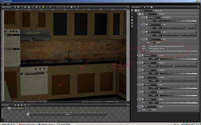

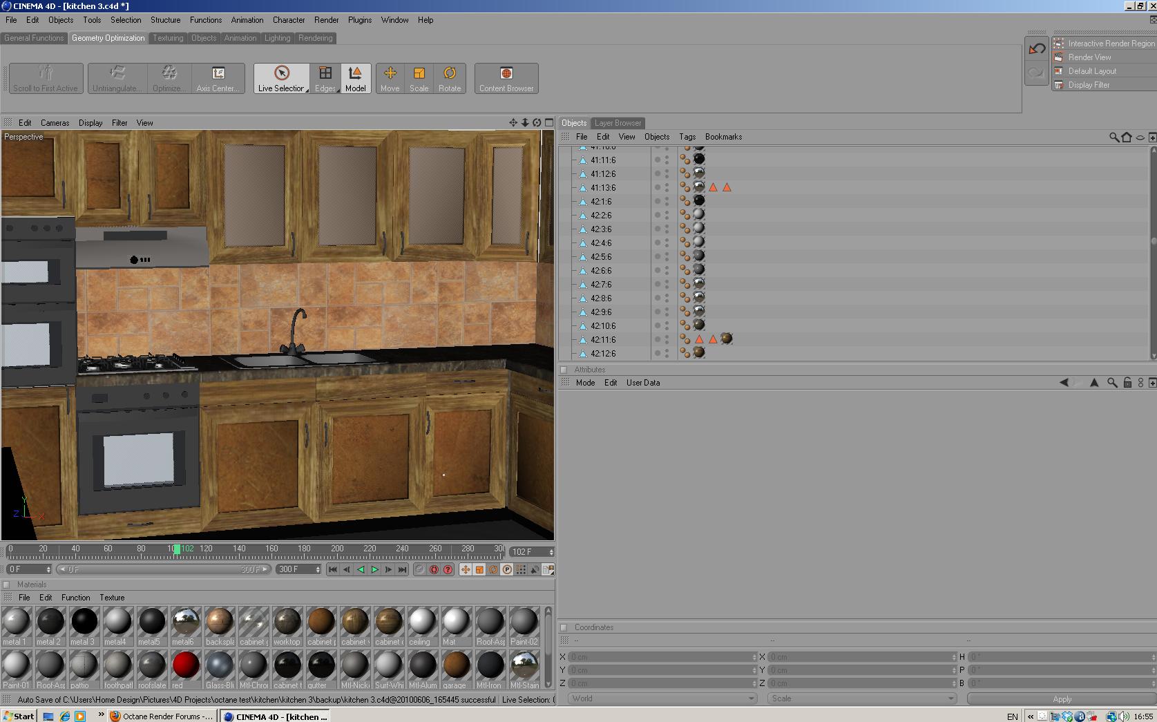

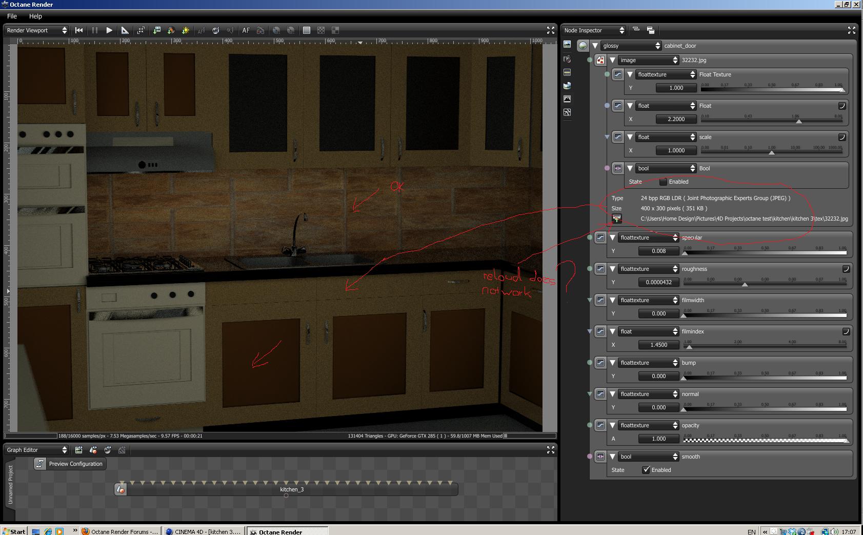

hi There
something is wrong here ,i think.
some of my texture maps get exported , some not
in octane the texture witch are not exported from C4d are only displayed as a color,but if i try to reload them again
from inside of octane, nothing happend ,they stay in the color they have been exported from C4d
they seemed to be blocked. i hope this makes sence
Rico
