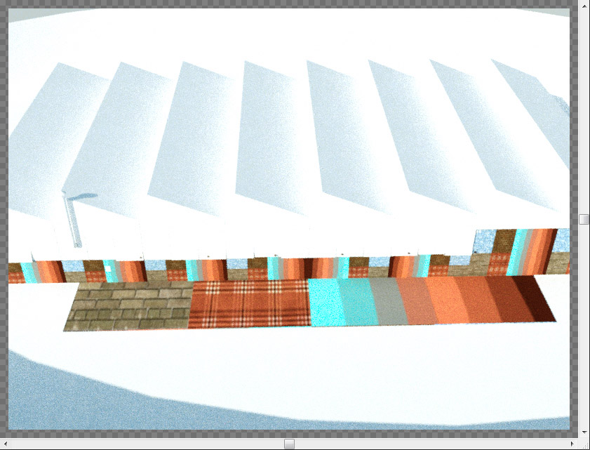

I managed to load up the test scene, see screenshot and this is what I get, it's completely mangled geometry.
The only thing I can think of is re-install max and the plugin? Would I have to re-install the standalone version as well?

btw that geometry you see there in the test shot, seems to be merged geometry of a scene I had loaded prior and it somehow combined them, even though I had loaded only the test scene in place of the old (not merged)... it does not seem to have removed the old geometry somehow or parts of it??

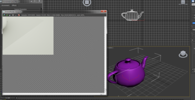

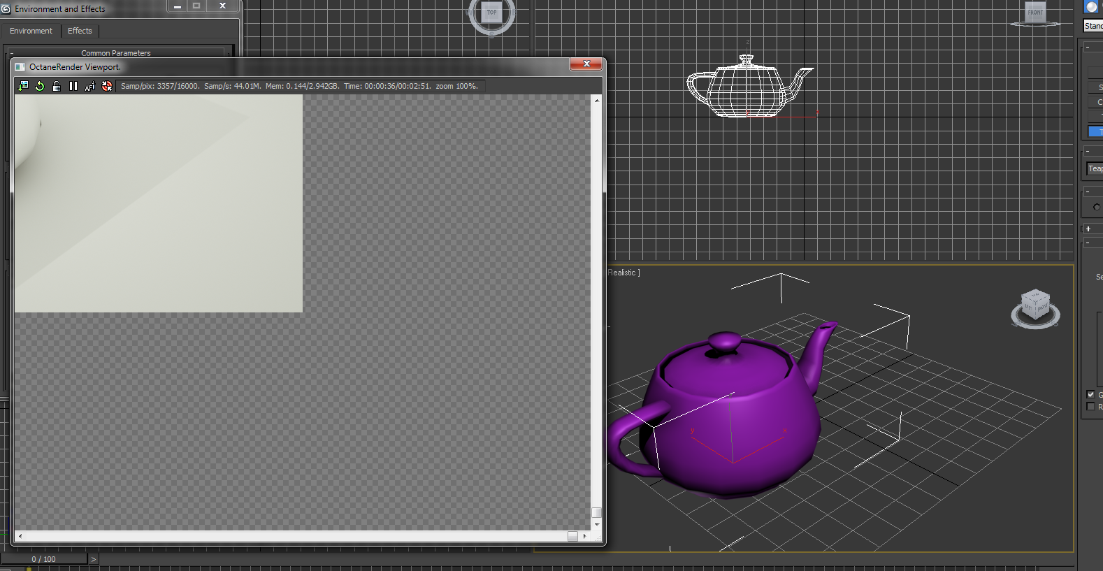

it's starting to do really crazy stuff, like rendering only a quarter of the scene

You can use middle mouse button to navigate viewport.
yes I can still move the object around in those cases... have not tried the center button
