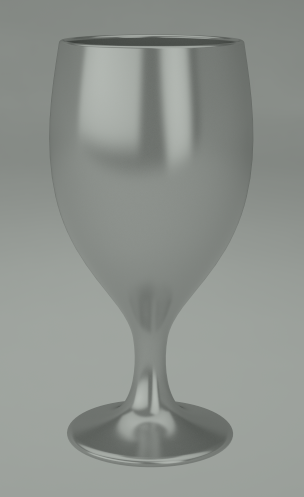

Seems that the smooth material + high resolution + MoI did the trick.

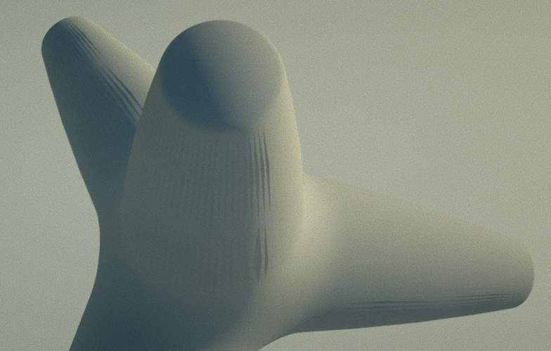

Hmm, with another model something is still not quite right...
that's maybe self-shadowing, can you try with an image enrivonment instead of the daylight systen environment ?Kaspar wrote:Hmm, with another model something is still not quite right...
Radiance
