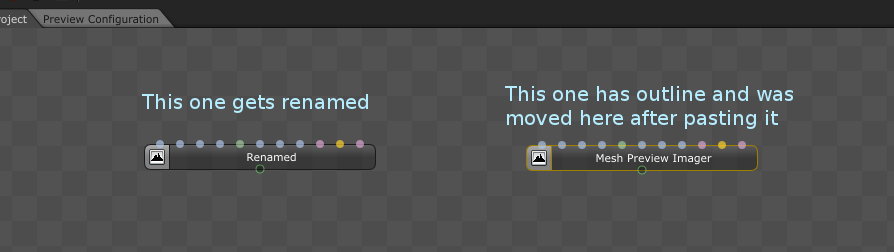

There's a little "bug" concerning copy/paste of nodes (present in previous versions too):
Take the "mesh preview imager" node (or any of the render target nodes, like camera, resolution...), copy it and paste it. The pasted node will have the outline, leading to believe it's the one selected, but in fact the old one is actually selected in the NI. If you try to change values in NI (like rename it) you will see that the values are changed on the old one, not the one that has the outline. Even if you drag the pasted node someplace else, the old one is still the "active " node. Only when you actually click (not just drag) on the pasted node (or click on empty space an then back) the focus is really transfered to it.
All the nodes exhibit the behaviour of not being actually selected when pasted, even if they have the "is selected outline", but those of the "render target type" also remain un-selected even when you drag them around - you must click on them to make them really selected.
