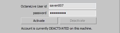

saven007
Posts: 9
Joined: Wed Feb 08, 2012 6:06 pm
I am here to enter forum Username: saven007and password
saven007
Posts: 9
In this window, enter the purchase of a username and password, is my steps have problems?

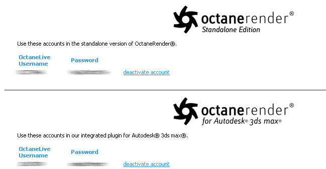

roeland
Posts: 1826
On our website in the customer area you will find the license keys. Log in and go to OctaneLive Accounts.
Use a license key for Octane Standalone in the black popup window.
Use a license key for Octane for 3DS max in the plugin.
Roeland

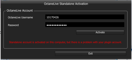

saven007
Posts: 9
You said I have found, you mean this one?And I have put these into black windows, but black below windows always shows a row of red font, tell me the registration failure.I wonder if you have a remote control function, if you can, remote control my computer to complete the registration?

gir1dhar
Posts: 6
Joined: Sun Jun 27, 2010 4:31 pm
Location: Buenos Aires, Argentina
I'm having the same problem. I'm entering my name and password as shown here http://www.refractivesoftware.com/accou ... nelive.php . Checked it several times, both are correct.
Is there a different key for the 3ds max plugin?
Octane (when run as stand alone) runs and say that it is activated on my machine.
3dsmax isn't blocked by the firewall in any way.
And btw, I just reinstalled octane and its plugin on a fresh computer after a long time. I hope to be able to use octane with 3ds max, at this time.
Win7 x64, i7 930, 6Gb ram, Geforce 480GTX
Karba
Posts: 2300
gir1dhar wrote:I'm having the same problem. I'm entering my name and password as shown here http://www.refractivesoftware.com/accou ... nelive.php . Checked it several times, both are correct.
You should have standalone name/pass and plugin name/pass like this
