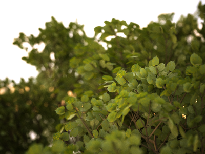

Hi, I was playing with Octane in my spare time and wanted to achieve translucent material on leafs. I made some test renders, don't know why Octane keeps crushing when I adjust the resollution or increase ray depth value of pathtracing, any ideas?

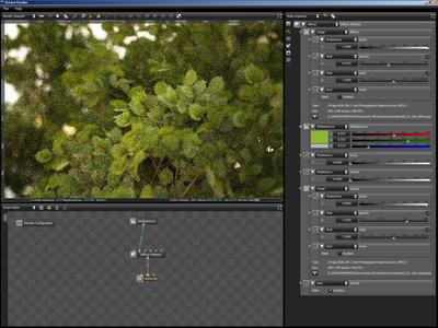

Rendertimes were about 10 minutes, I also post my material setup.

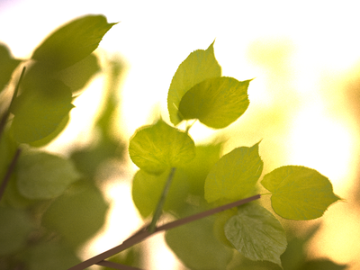

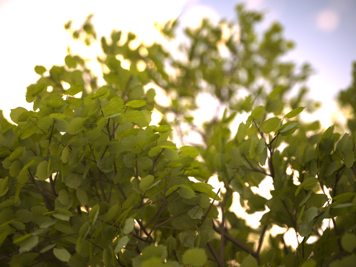

Quick translucency tests
wow... That is incredibly good, care to share the settings?

Very nice tests. Can you show us whole tree?

i don't understand

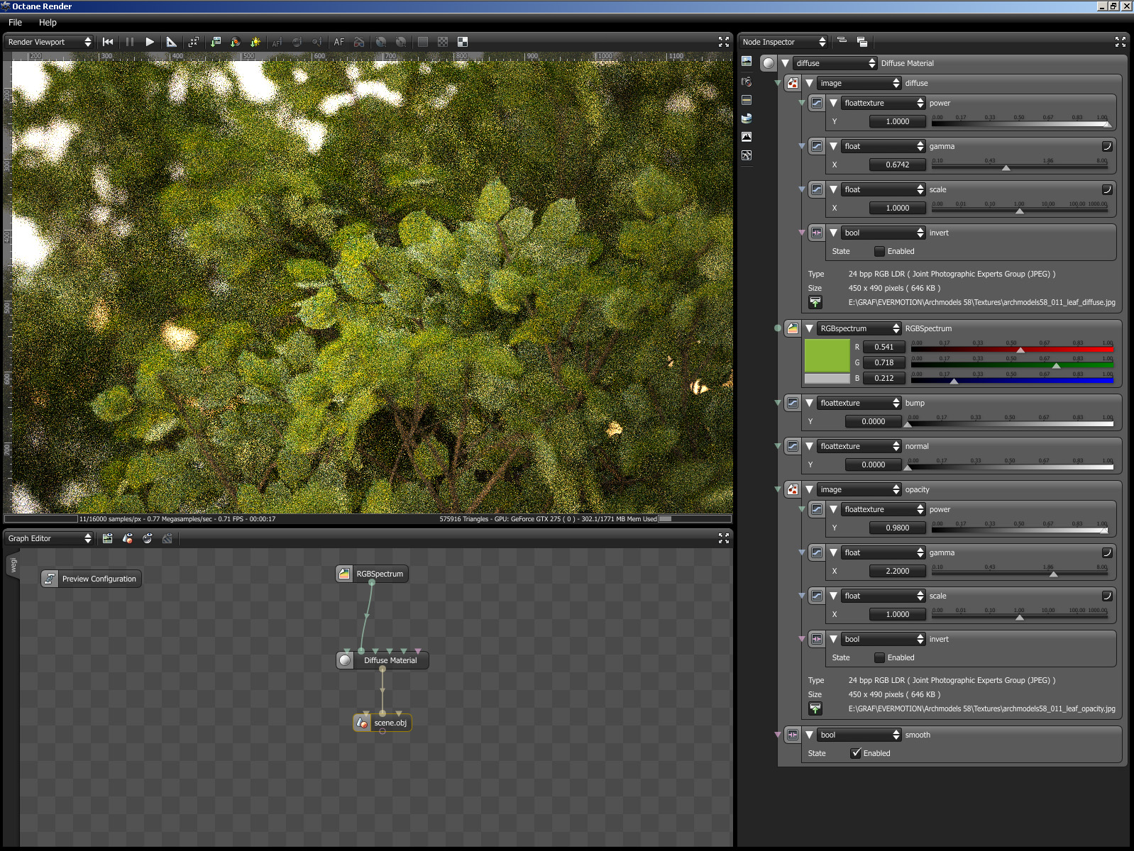

is this a bug ? because octane does';t support translucency yet, i tried to repdouce this and didn't succeed (i used the settings from the first image)
Core i7 860, ZOTAC GTX 580 - 3GB, 2 x GTX TITAN, 32Gb RAM
I've posted my settings in first post
You just need to create diffuse material, link it to object in mesh and then add another node (it may be rgb spectrum for example), and link it to transmission slot in previous diffuse material (empty dot slot).
Dude, you rock. These are some of the best plant renders from Octane to date. Very nice.
