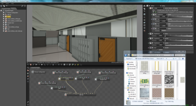

Im a newbie in 3D. Im trying to texture map my scenes to be render in Octane.
I bought a 3D model from Turbo Squid. The texture maps are all great ( in order where they should be and look )
Refer to my attachment. It did not tile the repeater patterns as suppose to. Why is it so?
When i try to add material and add texture, i find that i cant control when it should be mapped. ( on some cases , it flipped my texture 90degree clockwise. - landscape texture becomes portrait when apply to the OBJ in Octane.
How can overcome this problem?
Any advice ?

There is no option to map a texture.
You must do it with you 3d app.

You can tile a image texture by using the scale variable on the image node... if you want to be able to scale it independently on the x and y, change the scale from float to float2, that will allow you to give x y scaling options
