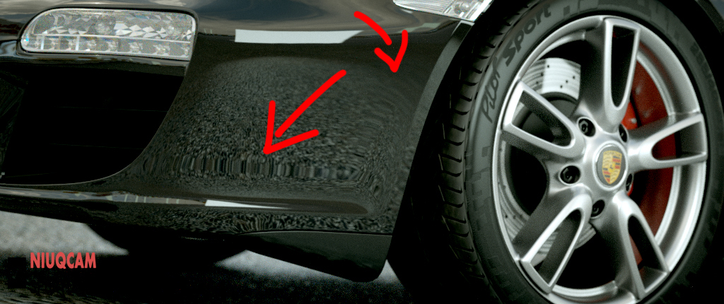

Hello,
I have a strange effect here :
I don't understand why. It concern only the reflection.
If i use a diffuse map with a photo, there is no distortion ...
Any ideas ?!
Thx
Niuq.

face
Posts: 3204
Location: Germany
What happens, when you turn smoothing off?
Maybe a normal issue...

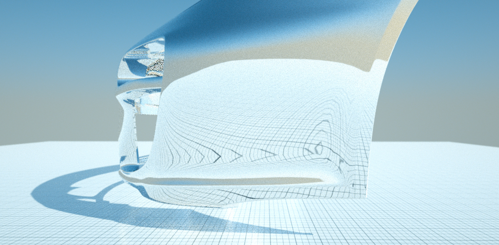

maybe a distorted u/v map on the bumper? apply a structured map (checker or whatsoever) to the bumper and see, if it looks right...

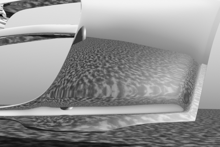

Booth bumpers are inverted. If i invert the normales from TEST_PARE_CHOC.obj that with the sphere, the bumper normals are wrong...

But that wasn´t the problem, the render looks the same...
Have checked it with Modo and it seems, that the reflection is correct.
The mesh has a unique form ;)

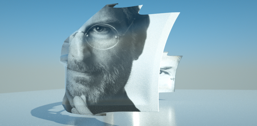

though the reflection looks odd. what bugs me is, that it is not possible to apply a simple texture mapping to that object. an octane checker procedural works, but also look odd (twisted). trying to map a photo of my cat onto it ;) just shows a grey surface, whatever scale i use... this is not normal (beside the normals), isn't it?

I never seen this kind of reflection on a reel car... very special car. :cry:
t_3 wrote:though the reflection looks odd. what bugs me is, that it is not possible to apply a simple texture mapping to that object. an octane checker procedural works, but also look odd (twisted). trying to map a photo of my cat onto it ;) just shows a grey surface, whatever scale i use... this is not normal (beside the normals), isn't it?
I can map a picture and there is not distortion... the problem is only with a reflection.
