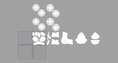

I am using Mari for texturing. The model i got is separated by patches. The uvs are spread out 5 quadrants horizontal and 3 quadrants vertically. so when importing into Maya all the textures would be placed in 0-1 uv space. I have to offset the u by using the translate node so that all the textures are assigned to the proper mesh. It works in Maya software render. I wanted to render using octane So i imported the single mesh but there is noway to offset the uv. All the textures goes to 01 uv space.
Here is the screen shot.
octissue.tif

You can simply overlap all your uvs in the [0,1] square. That should work.
To replace quickly your uv shells you could use this command: polyEditUV -u -1 -v -1;

I tried, it works partly. I think i will have to play with the scale values to fit in everything and match it up while importing from Mari to Maya.
