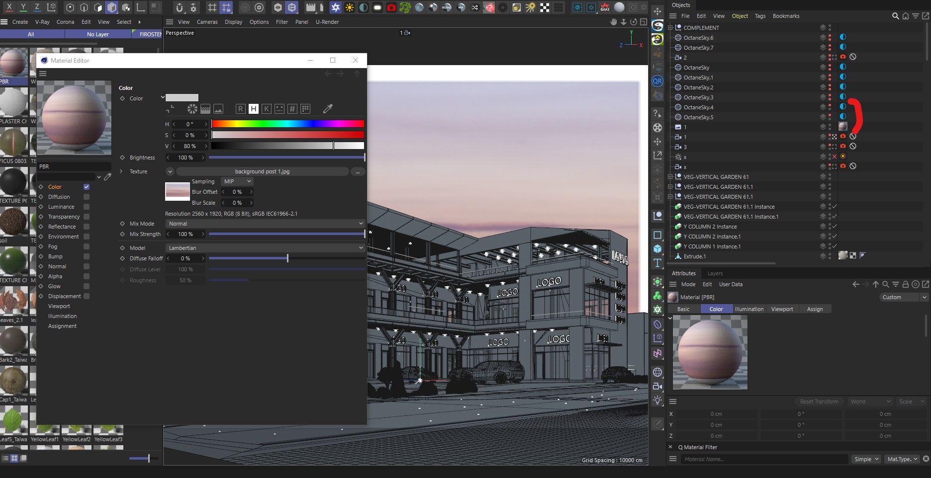

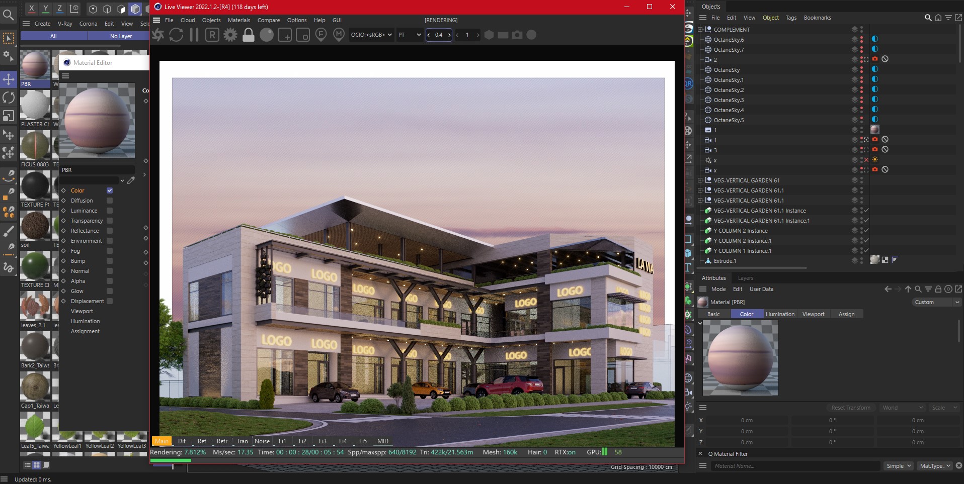

C4D background object can be used and be useful in some cases - I use different backgrounds techniques according to my needs. I like to blend the background everytime I can to avoid alpha glitches in photoshop.
In the image I show how I use the background object:
it allows you to use 1 environment object for lightning, 1 environment for reflection, refraction, and the C4D background for guess what... background.
I never made it to use 3 Octane environments for light, reflection, refraction and background. It's not perfect but this would be one way to do it. There are other ways.
Regards,
C4D material with native image in clolr channel, applied to Background pbject
Render in viewport - alpha channel must be active in engine kernel settings

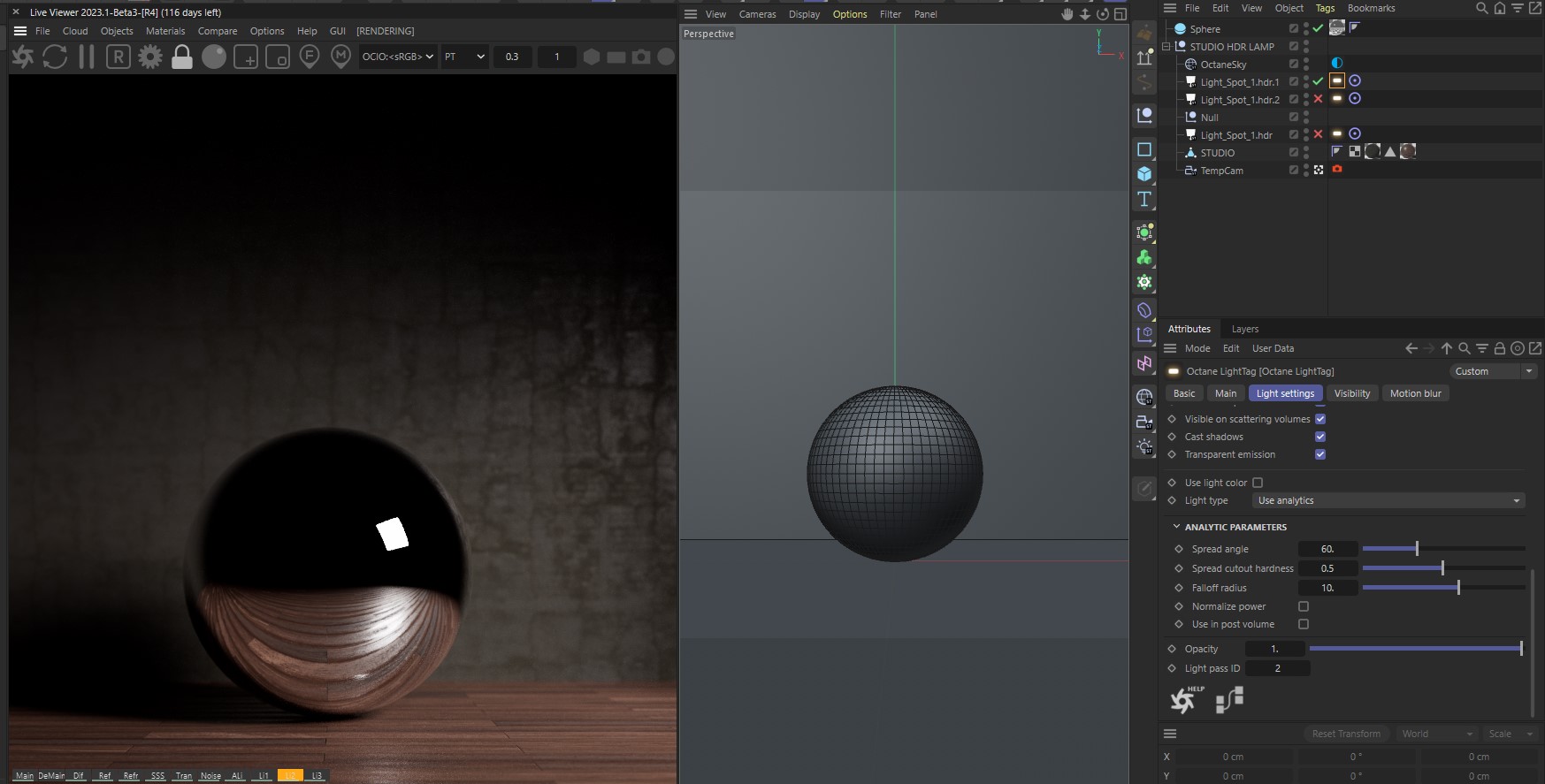

Is there a way to get C4D light linking working when using Analytic lights?
Seems to only work with Default or Primitive light types.
Also Analytic lights don't seem to work well with Light pass IDs either.
Is there a way to get them working correctly?
Many thanks

pandayoghurt wrote:Is there a way to get C4D light linking working when using Analytic lights?
Many thanks
Light Pass IDs are working (analytic) here for me.

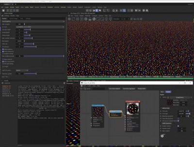

Chaos node is broken:
[string "Chaos texture"]:674: No pin "inputRGB" in nodes with type NT_TEX_OSL

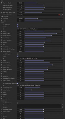

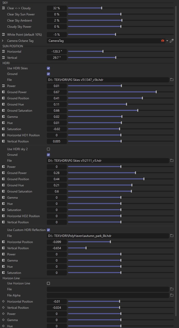

Anyway month ago I prepared rig for that :
- using one slider you can change sky from clear to cloudy with proper Sun intensity, shadow softness and overall sky color cast
- sliders for rotating whole sky horizontally and vertically
- switchers for using two HDRI maps instead which works with these sliders above
- additional HDRI for reflection only
- additional image as background for reflection only with alpha mask - like city, tree line
- all of them have exposure, saturation, gamma, hue corrections
- all of them you can move up, down, rotate
- for all of them you can add special ground mask to add additional color with corrections
example video attached or it is here https://www.youtube.com/watch?v=_En4Qf7DZZg

marcus1070 wrote:Chaos node is broken:
Chaos texture is working here:
