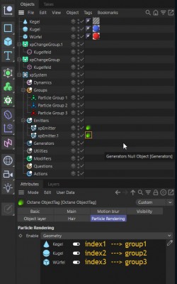

Didn't you read my reply? My answer explains the issue. It's a new addons and with your helps it can be improved. But it simply works as in picture. Needs to put objects to tag as used group numbers
xp-change-group.rar
(123.33 KiB) Downloaded 301 times

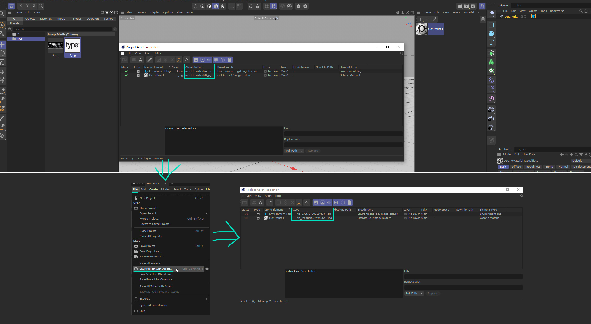

load texture from asset browser, click"save project with assets", it become break.
so sad, i can't share with others, or resue
