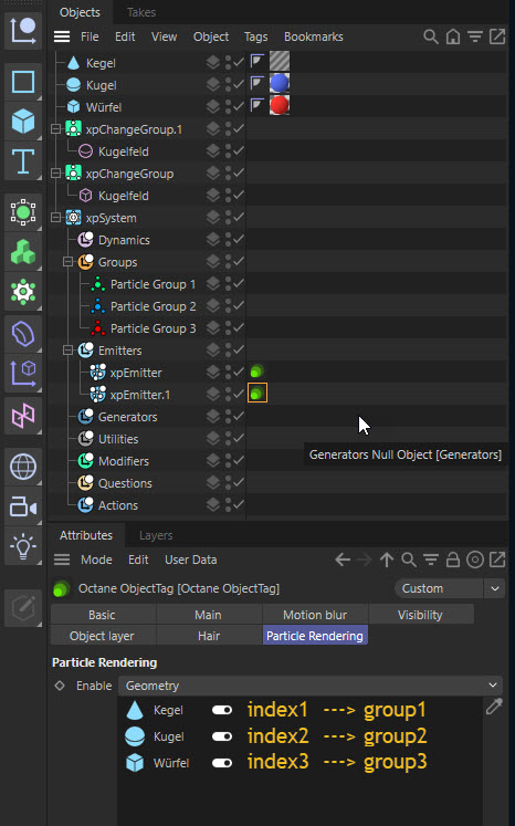

Didn't you read my reply? My answer explains the issue. It's a new addons and with your helps it can be improved. But it simply works as in picture. Needs to put objects to tag as used group numbersdasmodular wrote:Thank you! I tried that and it works, but it doesn't make sense to me.
Overall it is a great feature like every other one where the Octane plugin is working together with other third party plugins, but this still needs a little more usability.
