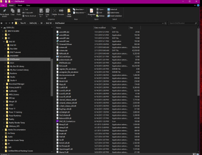

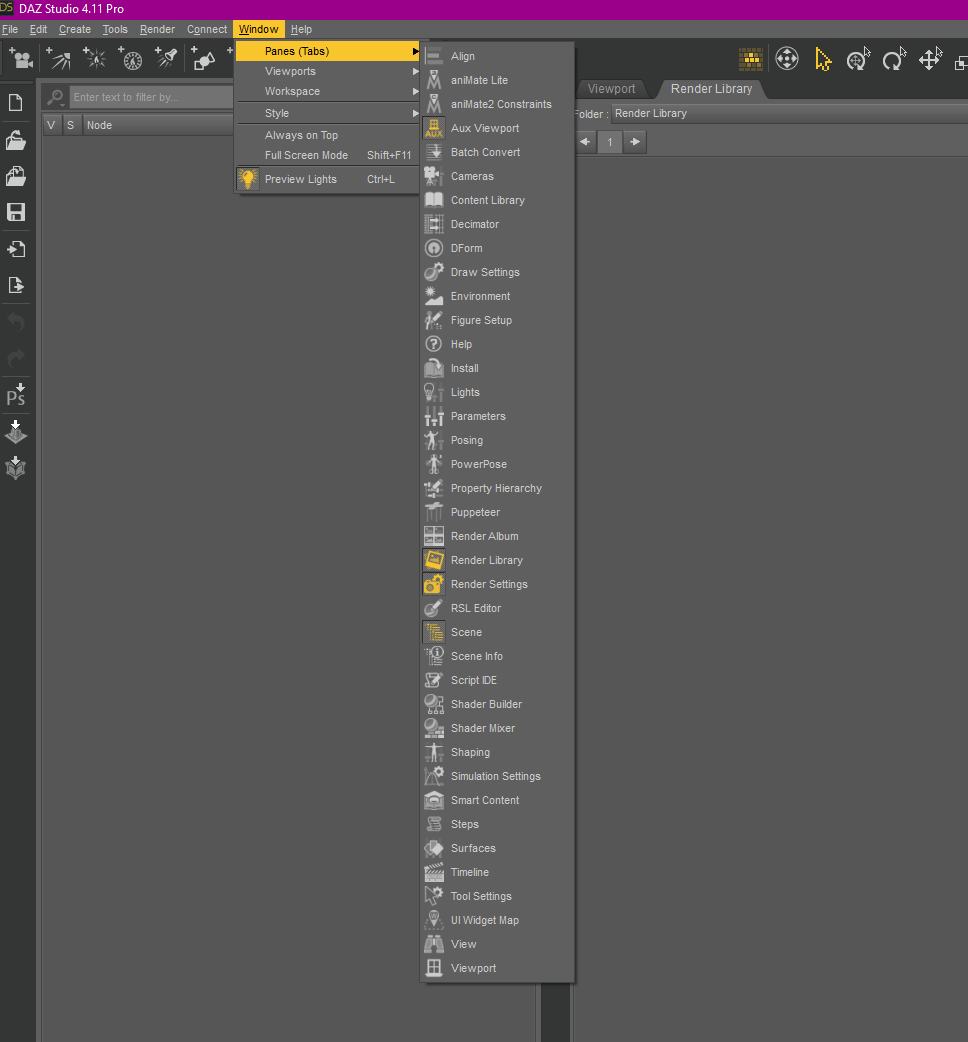

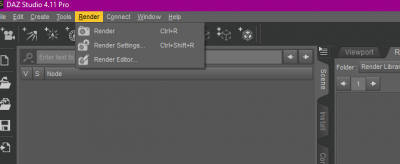

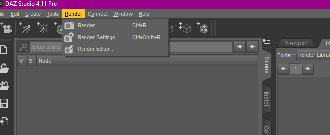

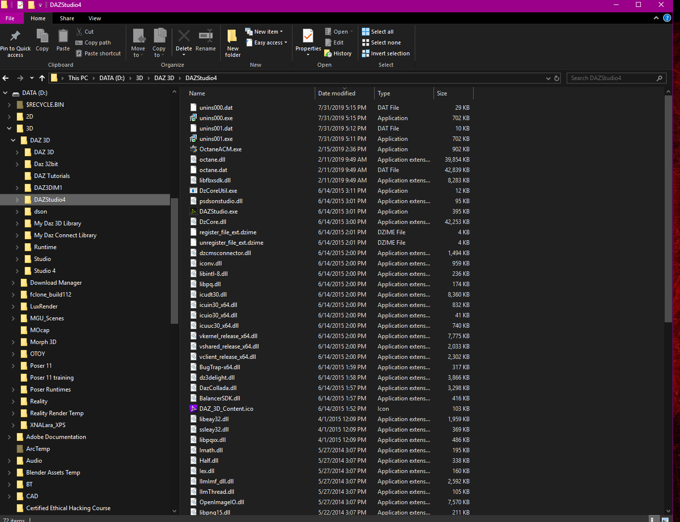

DigitalPanther
Posts: 4
Joined: Tue Jun 24, 2014 10:41 pm
[quote="face_off"OK, sounds like it's not a drivers problem then. Can you post screenshots of the DAZStudio Render menu, and the D:\3D\Daz3D\Daz Studio 4\ folder in Windows Explorer in date order (so octane.dll should be at the top).
Paul[/quote]
Thank you for your time on this it is really appreciated.
I have grabbed the requested screenshots as well as a shot of the window>Panes(tabs) menu where the docs said I should find the octane renderer.
Install folder
Install folder
Render window
Render window
Daz Window>Panes(tabs) menu
face_off
Posts: 15812
Location: Adelaide, Australia
Thanks. I notice that the octane.dll date is 11-Feb. Which version (ie. filename) have you installed please? Have you tried the latest release?
Paul
