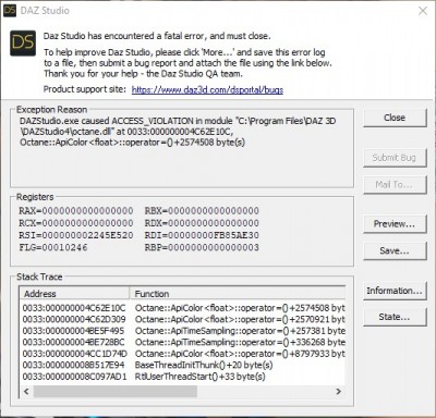

Hi Paul,
I can confirm I am not getting any of the issues I was facing with the Octane 4 RC version. But now I am getting a crash very often when I fiddle with the material in NGE. It always is at the same Octane::ApiColor method in the octane plugin dll. In most of the crash instances I was changing the Diffuse Texture. It crashed after I selected the new texture.
Crash
Crash
Daz Studio Pro - 4:10.123
Octane Plugin - 4.0.0.41
Ram - 128GB
GPU - RTX 2080 TI x5
OS - Windows 10 Pro x64
Nvidia - v416.94
Regards,
Rajib
