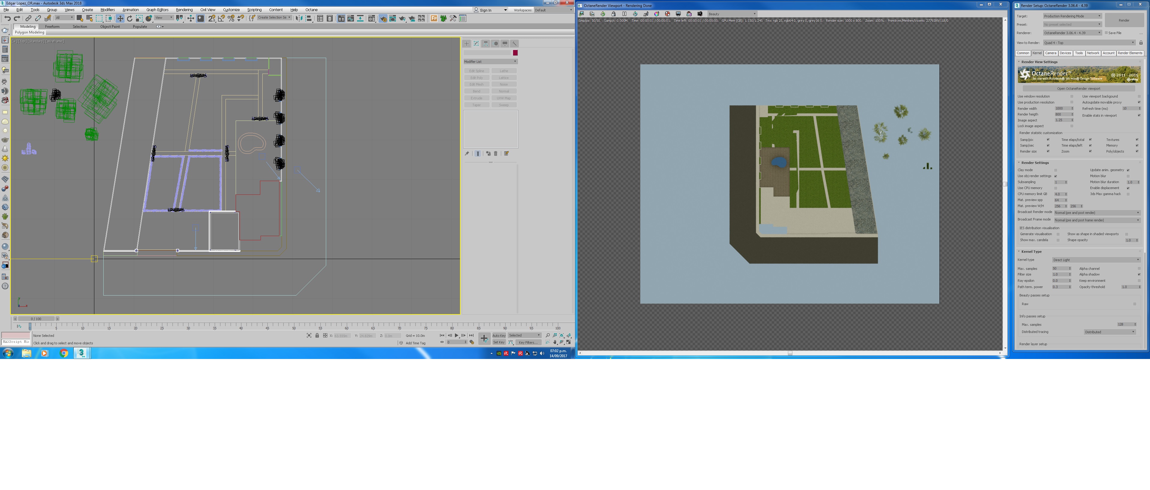

GOOD AFTERNOON
I HAVE A PROBLEM WHEN I USE OCTANERENDER 3.06.04-4.39, THE VIEWPORT IS LIKE A MIRROR, I DON'T KNOW WHY HAPPEN THIS
SOMEONE CAN HELP ME ?
THANK YOU
ADD IMAGE
paride4331
Posts: 4001
Hi merid888,
did you try using scanline renderer mode, does your issue still happen?
Regards
Paride
mbetke
Posts: 1307
Location: Germany
You are not using a camera and only a Top down view. This can happen. Sometimes if you zoom to much in, the scene diappears. Its a 3dsmax issue I think.
Try to set up a camera and render again. Then it should work.

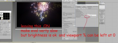

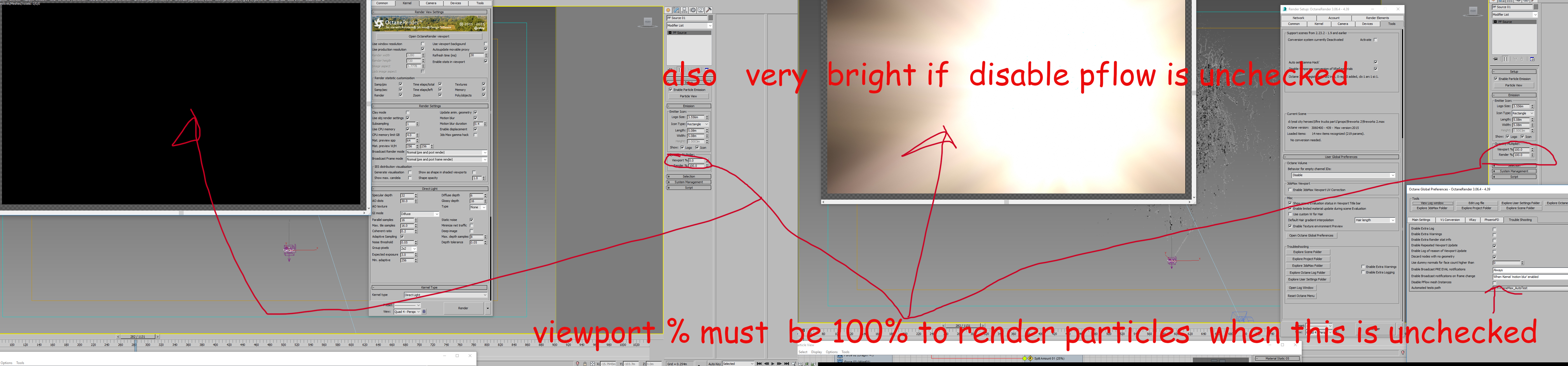

Hi It seems that if Disable PFlow instances is unchecked there are no pflow particles in octane viewport unless viewport % is set to something. Also particle brightness gets out of control.
when leaving a checkmark evaluation times is very slow but quantity multiplier viewport % can be left at 0 and brightness works ok.
so there is a big problem for us we have both pflow fire works and phoenix fire.
with Disable pflow mesh instances checked: PFlow is slow to load
with Disable pflow mesh instances UNchecked: phoenix fd evaluate 5-10 times slower
hopefully otoy can fix all this

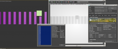

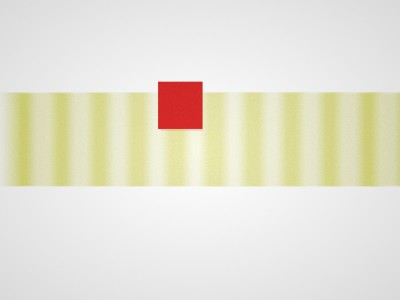

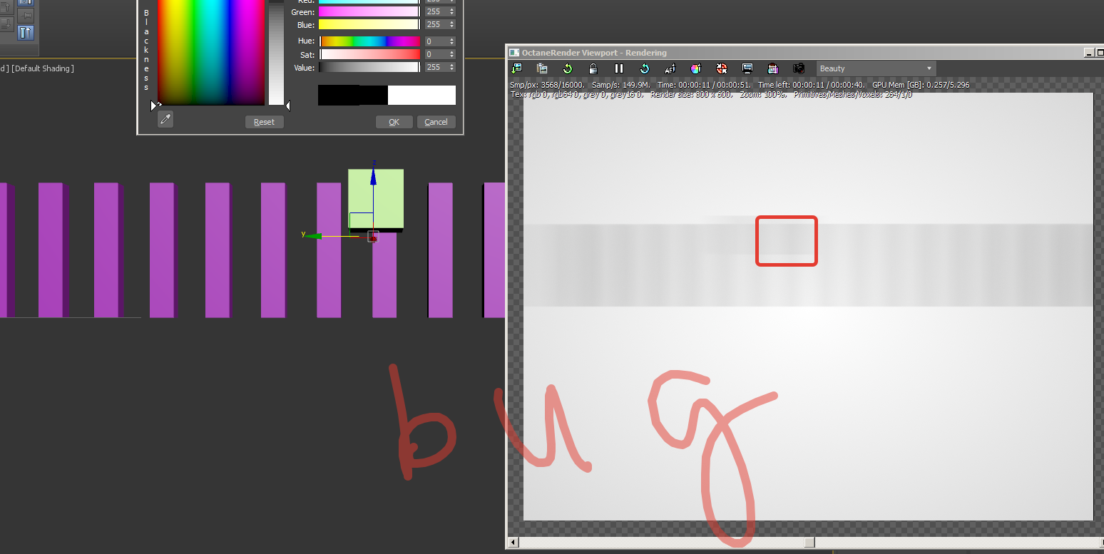

the movement of the cube and the camera - they have one speed .... the question is what would it take what would the cube had blur
motion kub camera.zip
(30.4 KiB) Downloaded 294 times

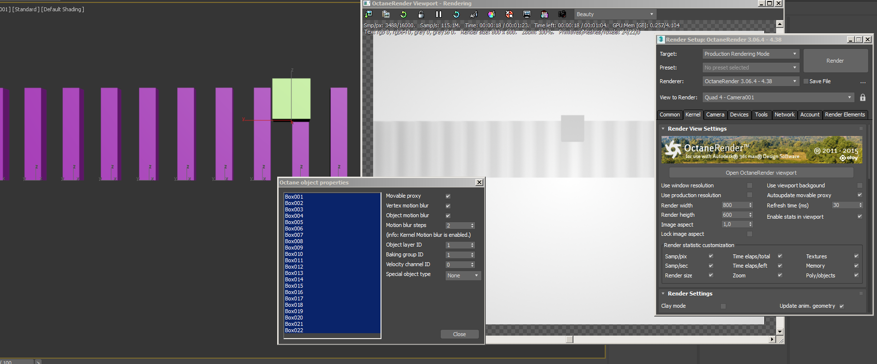

paride4331
Posts: 4001
Hi Goldisart,
you should activate movable proxy and MB in Octane property.
attached correct scene.
Regards
Paride
