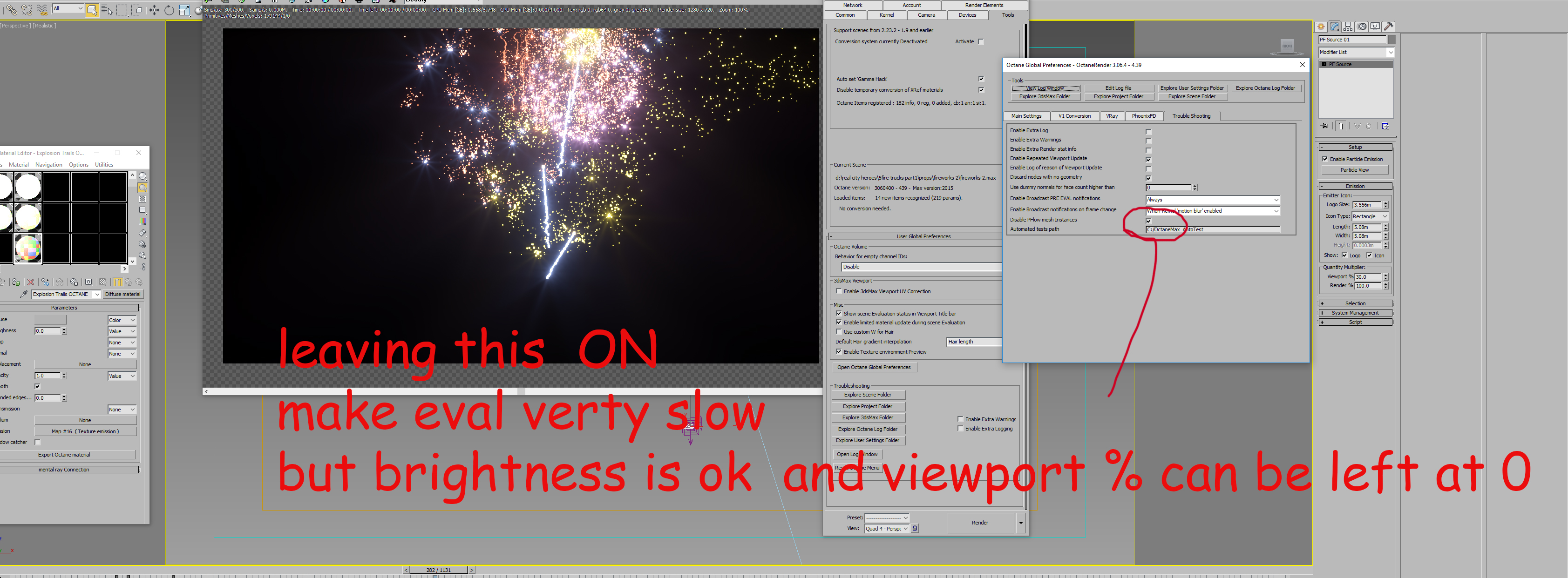

Hi It seems that if Disable PFlow instances is unchecked there are no pflow particles in octane viewport unless viewport % is set to something. Also particle brightness gets out of control.
when leaving a checkmark evaluation times is very slow but quantity multiplier viewport % can be left at 0 and brightness works ok.
so there is a big problem for us we have both pflow fire works and phoenix fire.
with Disable pflow mesh instances checked: PFlow is slow to load
with Disable pflow mesh instances UNchecked: phoenix fd evaluate 5-10 times slower
hopefully otoy can fix all this

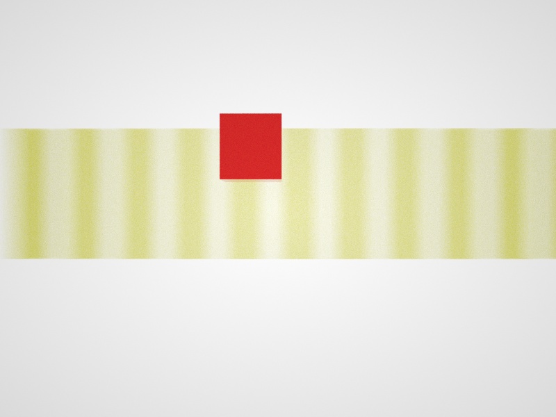

the movement of the cube and the camera - they have one speed .... the question is what would it take what would the cube had blur

- paride4331
- Posts: 4001
Hi Goldisart,
you should activate movable proxy and MB in Octane property.
attached correct scene.
Regards
Paride
Regards
Paride
