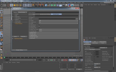

hello aoktar.
all superb. works like a charm. i just can not find the render layers in LiveViewer any more... any hint? :DD
fuchsundvogel
Posts: 102

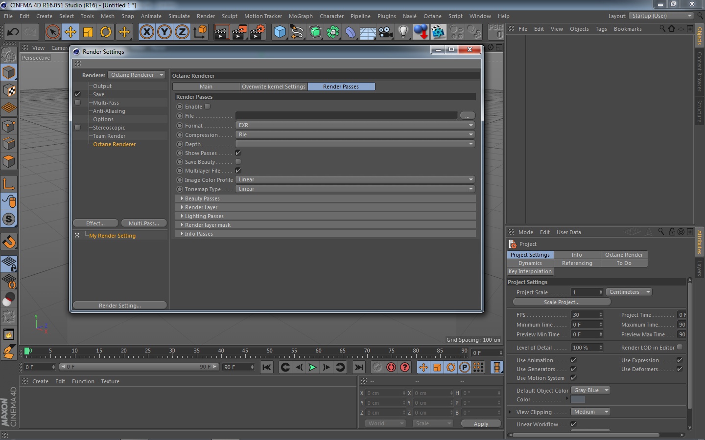

Joined: Tue Jan 06, 2015 3:21 pm
activate renderpasses in rendersettings
momade
Posts: 349
Joined: Wed Feb 19, 2014 9:52 pm
Location: Cologne - Germany
I must be so blind! can't find it...

yes. for picture viewer rendering it works fine. i'm looking for the LiveViewer Render Passes Settings...

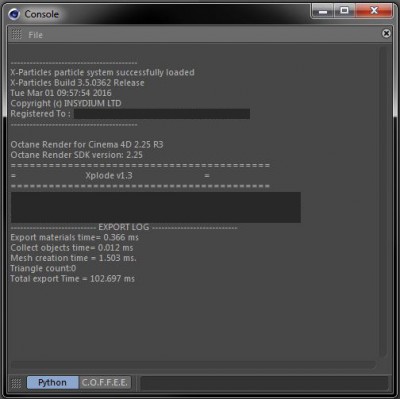

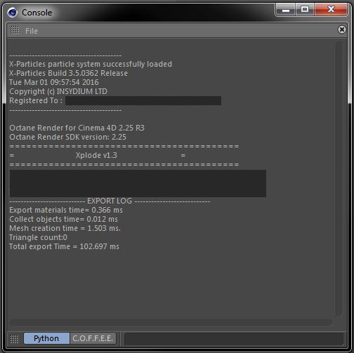

Sorry aoktar.
I guess I have an issue here. Mayebe you can help...
I uninstalled EVERYTHING that had to do with otoy or octane to make a clean cut.
reinstalled the c4d plugin und it works without SDK...
here is a console screenshot:
there are NO files in any OTOY folder on my system. still octane for c4d works alone and i still have no render passes option in LiveViewer:
