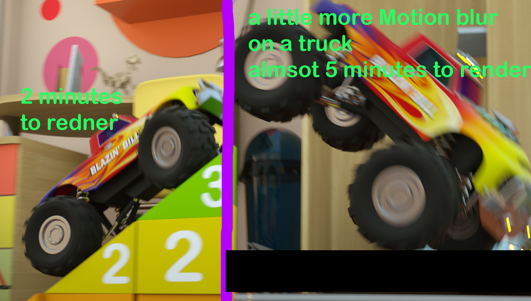

here is my example what happens if objects moves a bit faster creating more motion blur render time doubled. Truck was cropped in the second picture but both frames have same size truck and environment
