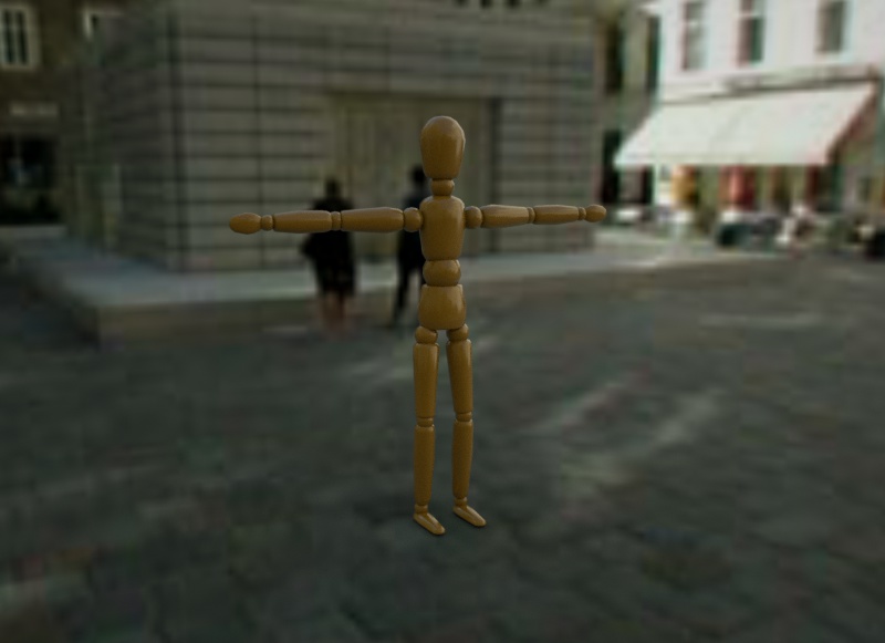

EINBLICKE
Posts: 27
Joined: Thu May 19, 2011 7:23 am

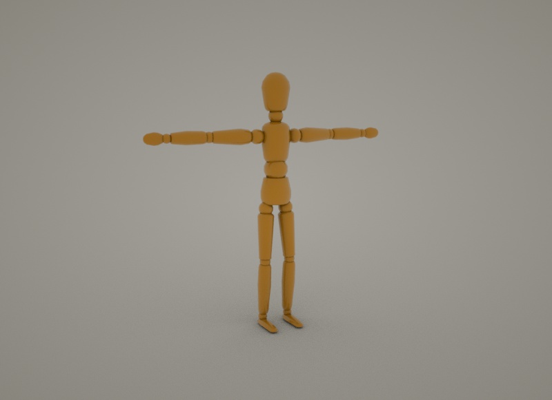

EINBLICKE
Posts: 27
EINBLICKE
Posts: 27
the first is your´s with jpg. texture environment
the second is my with hdr environment
