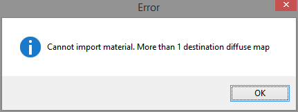

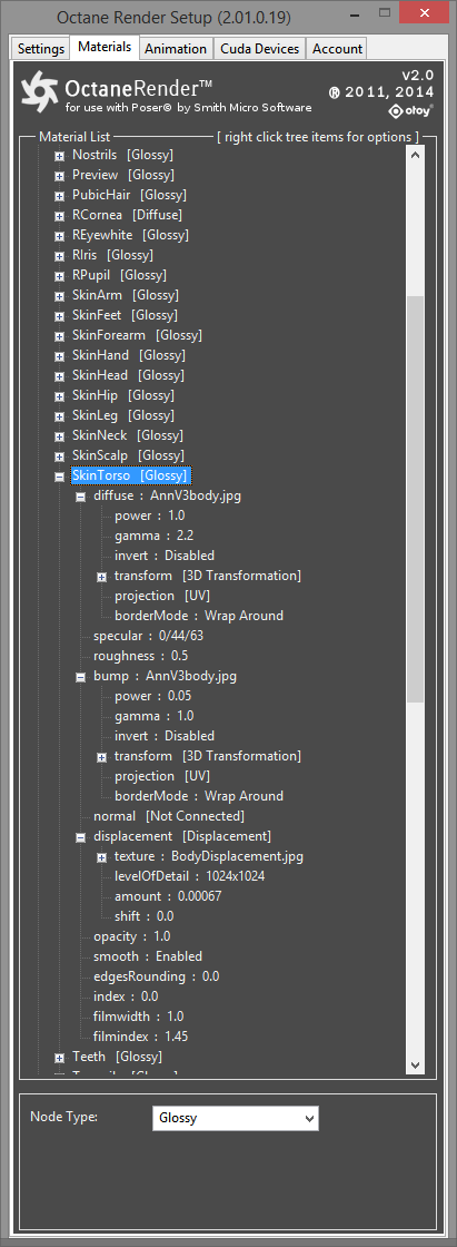

There is an error when importing saved materials to a node that has a displacement assigned:
Material
Material
Error message
Error message
Screenshot 2014-06-29 17.10.41.png (3.28 KiB) Viewed 4649 times
I couldn't reproduce this. Are you able to provide a workflow that I can follow to get this error pls?
Paul
