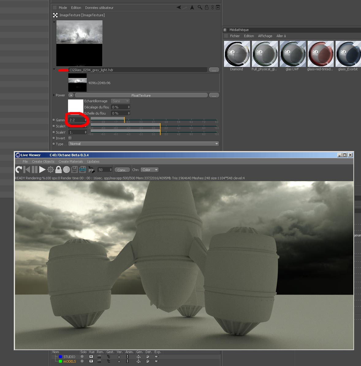

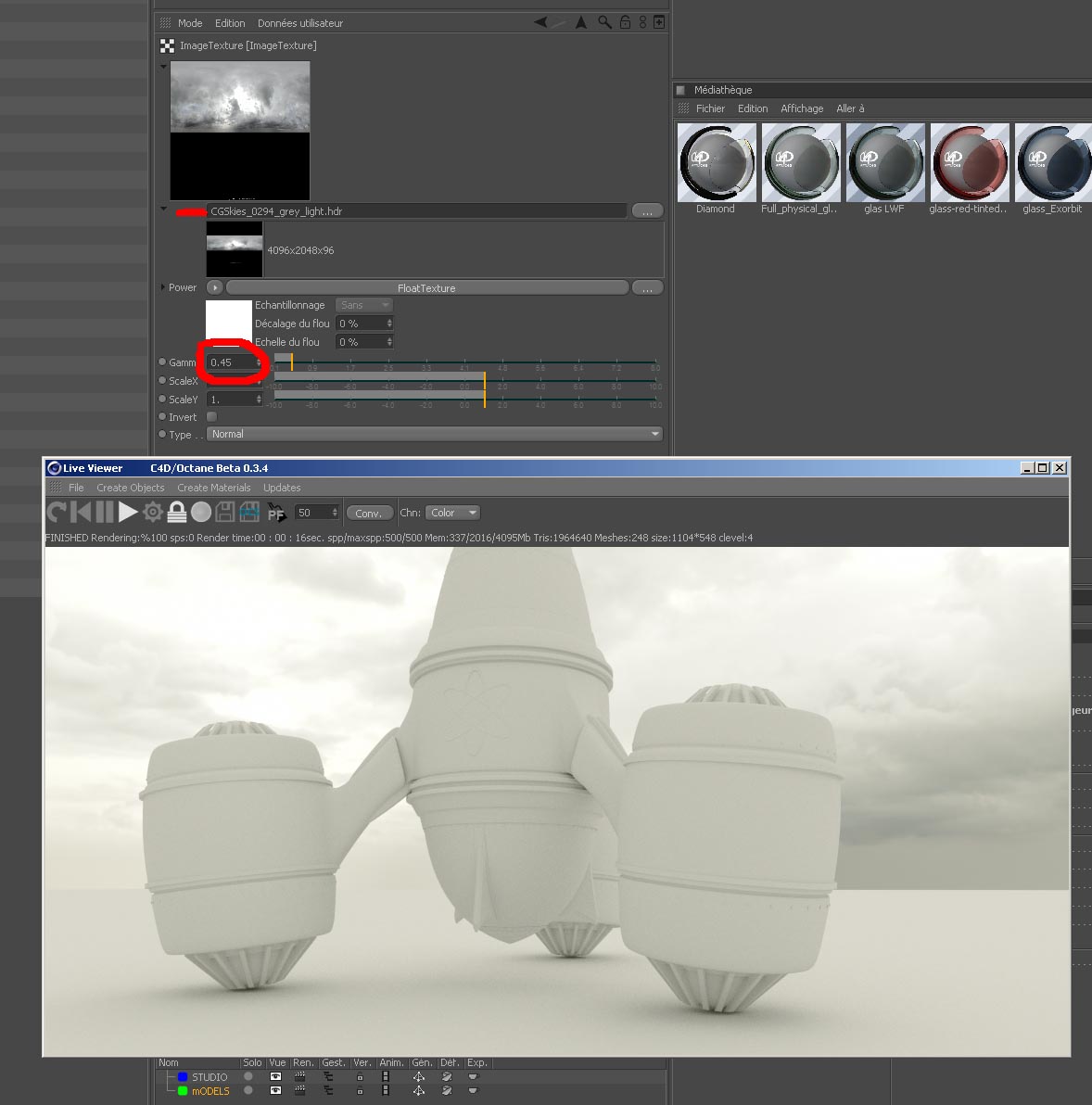

Correct me if im wrong, but the gamma cursor seems to be inverted like ?
gamma 0.45 should it not be more dark and crispy than 2.2?
gamma 0.45
gamma 2.2
thanks
pxlntwrk.net
Posts: 10606
it's exactly how it works on standalone since the very beginning, but i don't know why :D
anyway, in octane you must set the hdr gamma to 1 in order to have the correct illumination, gamma >1 are useful for getting more contrast and less blurry shadow ;)
ciao beppe
