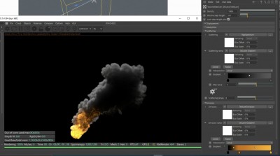

do we have to adjust colors in embergen or for octane it doesnt matter https://youtu.be/6Zq0nSNgE7A
Can we render particles with OCtane exported from embergen?
Posts: 10633

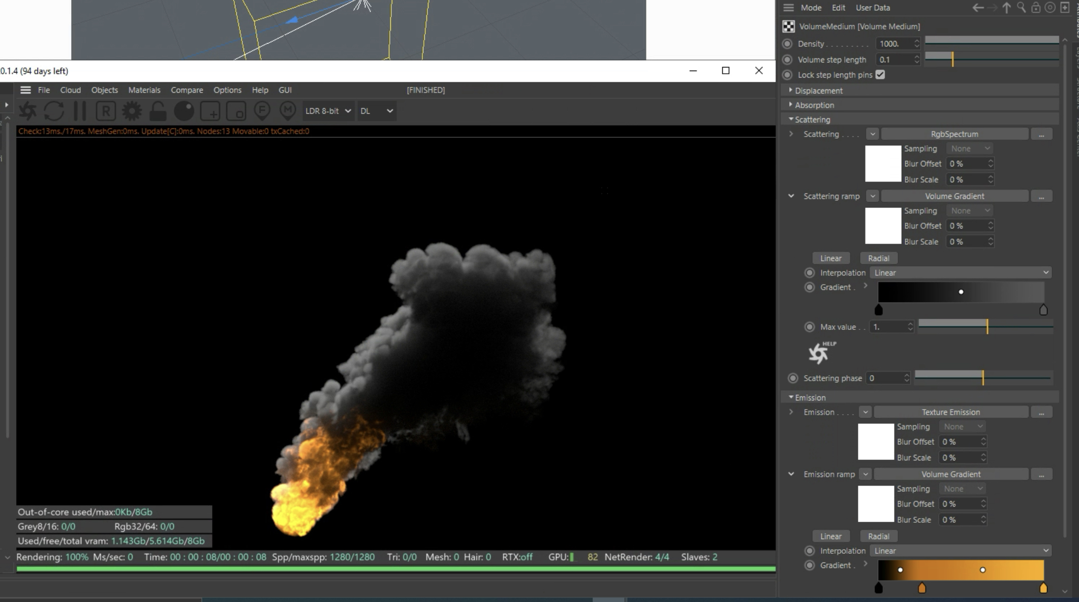

about coloring, you need to use a Volume Gradient in Scattering Ramp for diffusion, and in the Emission Ramp for the flames, the only trick is to always start with a black color from the left in the gradient:
ciao Beppe
coilbook
Posts: 3176
bepeg4d wrote:Hi,
ciao Beppe
Thanks and this is done in 3ds max "Volume Gradient in Scattering Ramp for diffusion, and in the Emission Ramp " not in embergen?

coilbook wrote:
bepeg4d wrote:Hi,
ciao Beppe
The example that Beppe shows was done in Cinema 4D, but I imagine the same thing can be done in 3dsmax.
