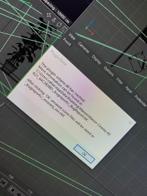

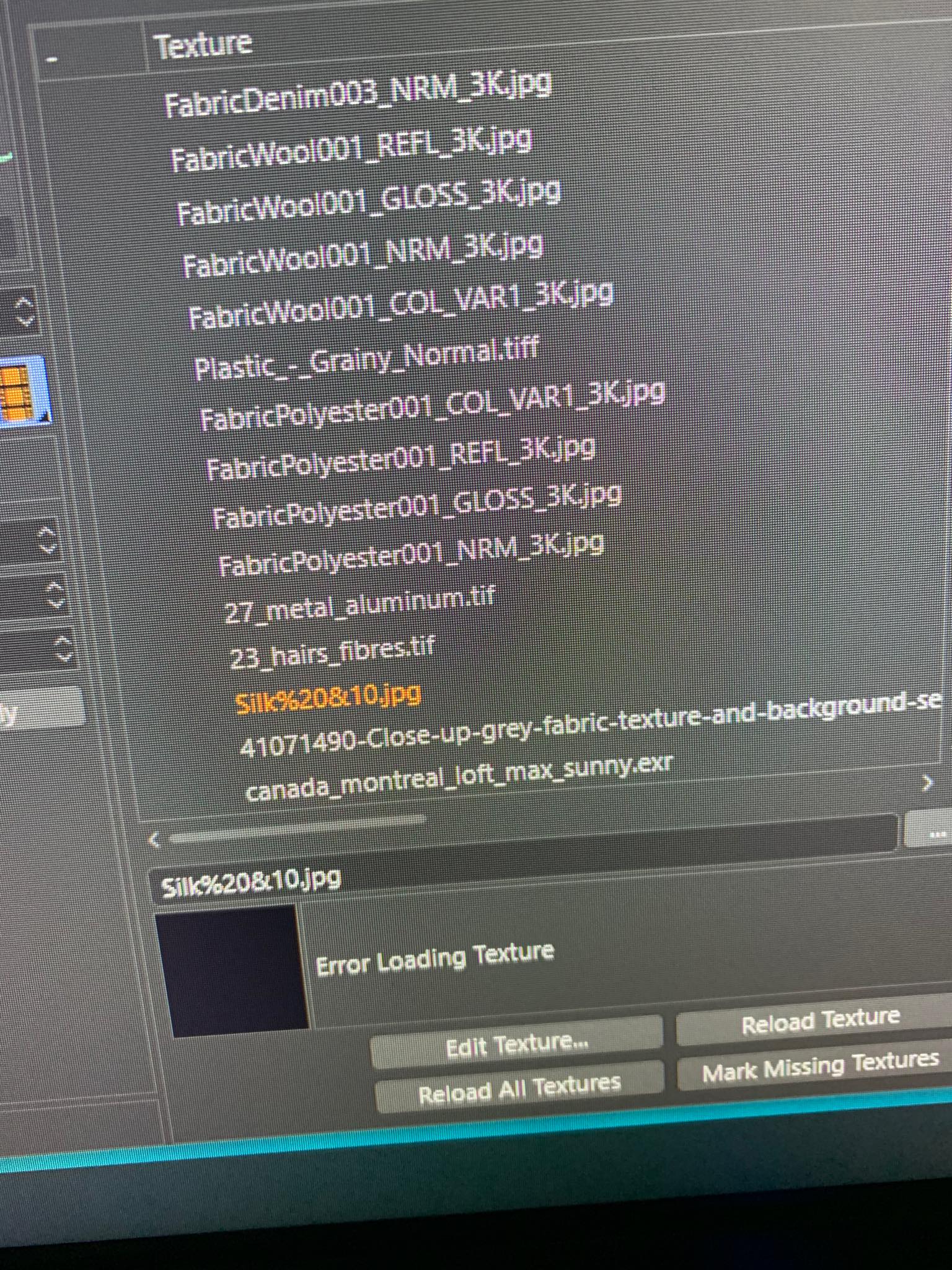

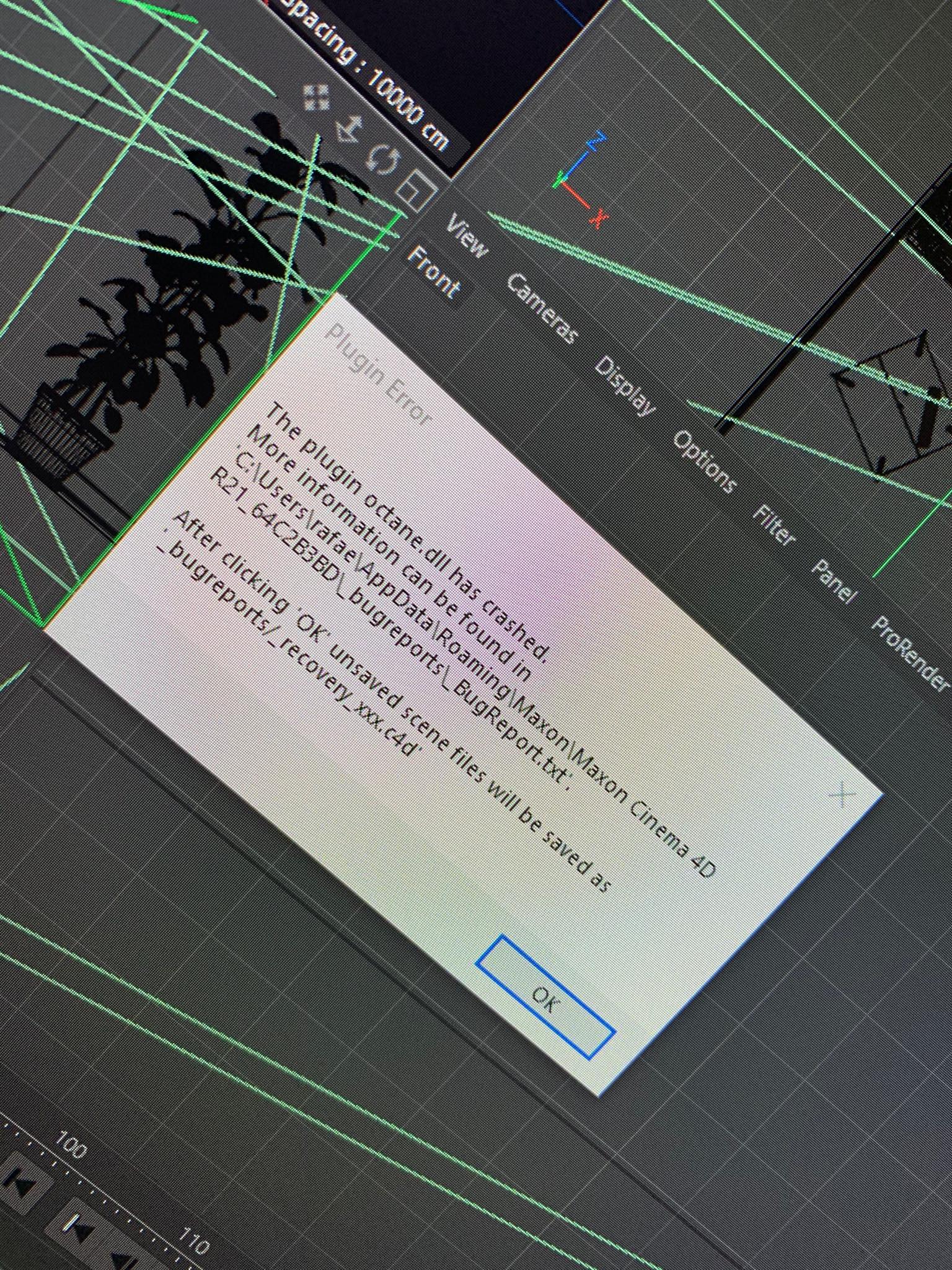

Hi, so i have some problem. If i have c4d files with "Texture" paths missing an the textures a Error to load the Octane Plugin crashes all time. You can only open a new file with no "error "paths" and than fire octane again. Let it open, open a the file with the lost "texture" paths and fix the paths. Then it works. But if you dont fix this missing path with a new file with no missing paths all files that you are open are getting a error. PLEASE fix this shit. I cost me so much time. THX

rclassenphoto wrote:Hi, so i have some problem. If i have c4d files with "Texture" paths missing an the textures a Error to load the Octane Plugin crashes all time. You can only open a new file with no "error "paths" and than fire octane again. Let it open, open a the file with the lost "texture" paths and fix the paths. Then it works. But if you dont fix this missing path with a new file with no missing paths all files that you are open are getting a error. PLEASE fix this shit. I cost me so much time. THX
Make some tests with disabled material and opengl previews. Is it still crashing?

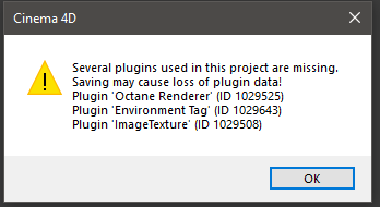

I also have the issue that Cinema 4D does not recognize my Octane 2019.1.5-R2 installation.
Standalone works fine. I have installed may iterations of the Octane plugin before, but can not get this one to work.
My previous working plugin was 2019.3.
C4D is up to date, Nvidia driver is 436.15.
Any ideas?

Hi Turck,
have you updated C4D to the latest version?
Please go to c4d menu Help/Check for updates.
ciao Beppe

I am on R21.022 (RC), no updates available. Nvidia driver is up to date now, too.
Is that the newest version of C4D?
Error Message
Error Message
Posts: 10633
Hi Turk,
latest R21 is R21.115.
@shine71:
please, remove the installed version, and download and install again v2019.1.5-R2.
Here it is working as expected with Image Tiles node.
ciao Beppe
