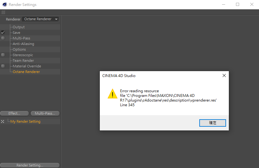

I can confirm the following problem in the windows version.
arleksey wrote:when i tried to open Octane Render 3.03.1 - R1 render settings (CTRL+B) i get this error, R17
3.02-R2 works well
Alex2002
Posts: 2
Joined: Sun Jul 03, 2016 8:39 am
I got the same issue,
open Octane Render 3.03.1 - R1 render settings, get error.
C4D version: R17.048

Alex2002 wrote:I get the same issue,
OSX? Can't see the problem on windows version.

vi-ex wrote:I can confirm the following problem in the windows version.
3.02-R2 works well
I think this is first time that you run V3. It makes a copy of vprenderer3.res to vprenderer.res from c4doctane/res directory.
You can fix it by run the C4D as administrator or make it by your self. I think windows avoid to copy it when you have c4d in program files.
I'll change the system for next version.
Alex2002
Posts: 2
Hi, aoktar
My systeam is WIN 10~
Live viewer render is ok, but can't open render setting.
