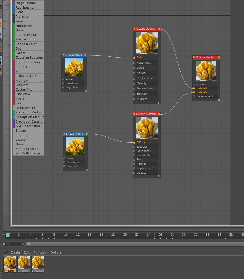

Concerning the bug I found, reproduction is quite easy, no need for a file:
- Create 2 Octane Materials in the C4D Material window
- Open Node graph, the currently activated Material will be shown there
- Now try to drag the other material into the node graph window so it is placed next to the already existing material -> it doesnt work, it only shows ONE of the material, but cant show you both at the same time. Major hinderance. No way to connect those material so you can use same nodes on them.
fixed.DinoMuhic wrote: - Create 2 Octane Materials in the C4D Material window

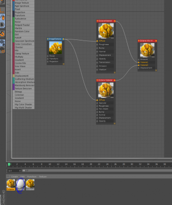

when i connect two materials with the same imagenode the preview of the second material is always white, also when i force rerendering of the shaderballaoktar wrote:fixed.DinoMuhic wrote: - Create 2 Octane Materials in the C4D Material window
