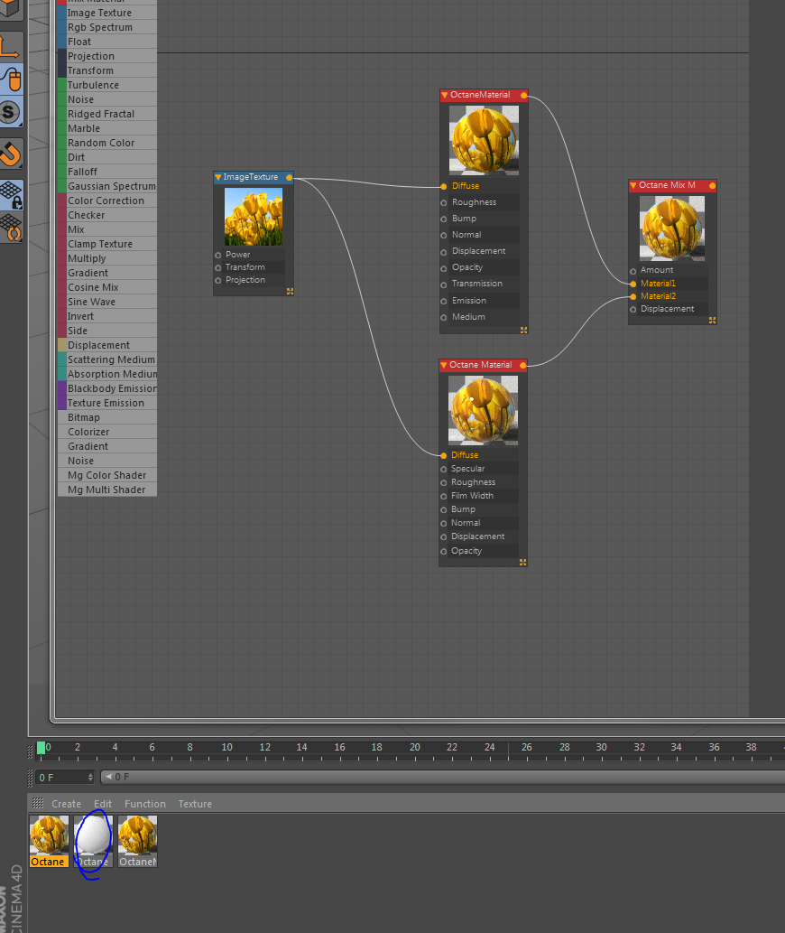

when i connect two materials with the same imagenode the preview of the second material is always white, also when i force rerendering of the shaderball
