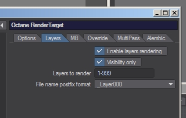

Juanjo, I can't believe I am just now catching this, but Diffuse/Matte is not working in render layers. If I have just my main obj and diffuse/matte obj (shadow catcher) set as Layer 2 and everything else is Layer 1 (which masks Layer 2, obviously), the darn thing just does not show up... even making it the only obj in Layer 2. No emergency, since I have workarounds, but this should work, no?... Please advise.

FrankPooleFloating wrote:Juanjo, I can't believe I am just now catching this, but Diffuse/Matte is not working in render layers. If I have just my main obj and diffuse/matte obj (shadow catcher) set as Layer 2 and everything else is Layer 1 (which masks Layer 2, obviously), the darn thing just does not show up... even making it the only obj in Layer 2. No emergency, since I have workarounds, but this should work, no?... Please advise.
I think that to work with this workflow you need enable the "Visibility only" feature in the Layers option.
