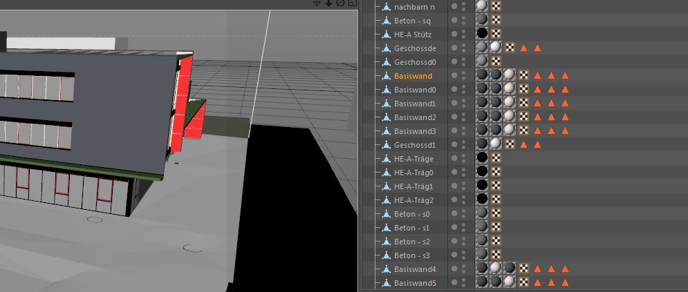

please help
maype there is a professional Cinema user!
how can i get a Cinema model devided by materials? i just want a simple polygonobject for each material.
means to undo all the polygonselection-tags for the whole model!?
group afterwards by materials.
is there a plugin/export-way to reach this with one step?
otherwise i don`t see a "economic" way to texture my models from revit.
thx

@huebner - you have at least 2 ways to do it: 1) export obj from revit -> export options -> export by material group; 2) manually modify your scene by opening the material -> assignement -> select all objects -> go to the object tree -> right click -> merge and delete. Repeat it for all your material and you'll get as many objects as your materials number.

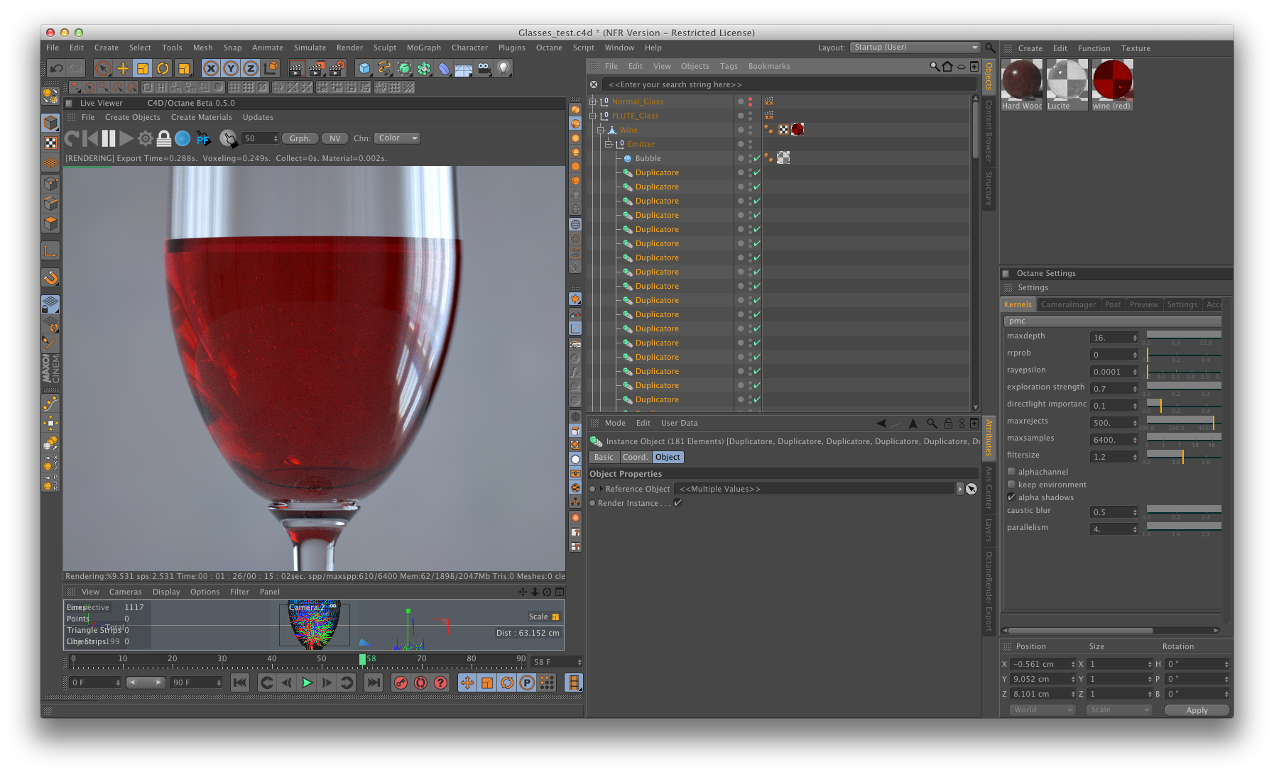

@aoktar - yes ... the scene attached works fine because the Render Instance check is set to off. Try to set it ON and then render to reproduce the crash. Thank you in advance. (if Render Instance is not checked... does Octane save vram anyway?)

hi andrea, no problem here with your scene, try disabling the "render perfect" option in the bubbles spheres and remember to invert the lathe nurbs and activate the "fake shadow" option in the specular materials ;)
with liquids in glass it's necessary to slightly overlap the two geometries for a correct refraction effect ;)
