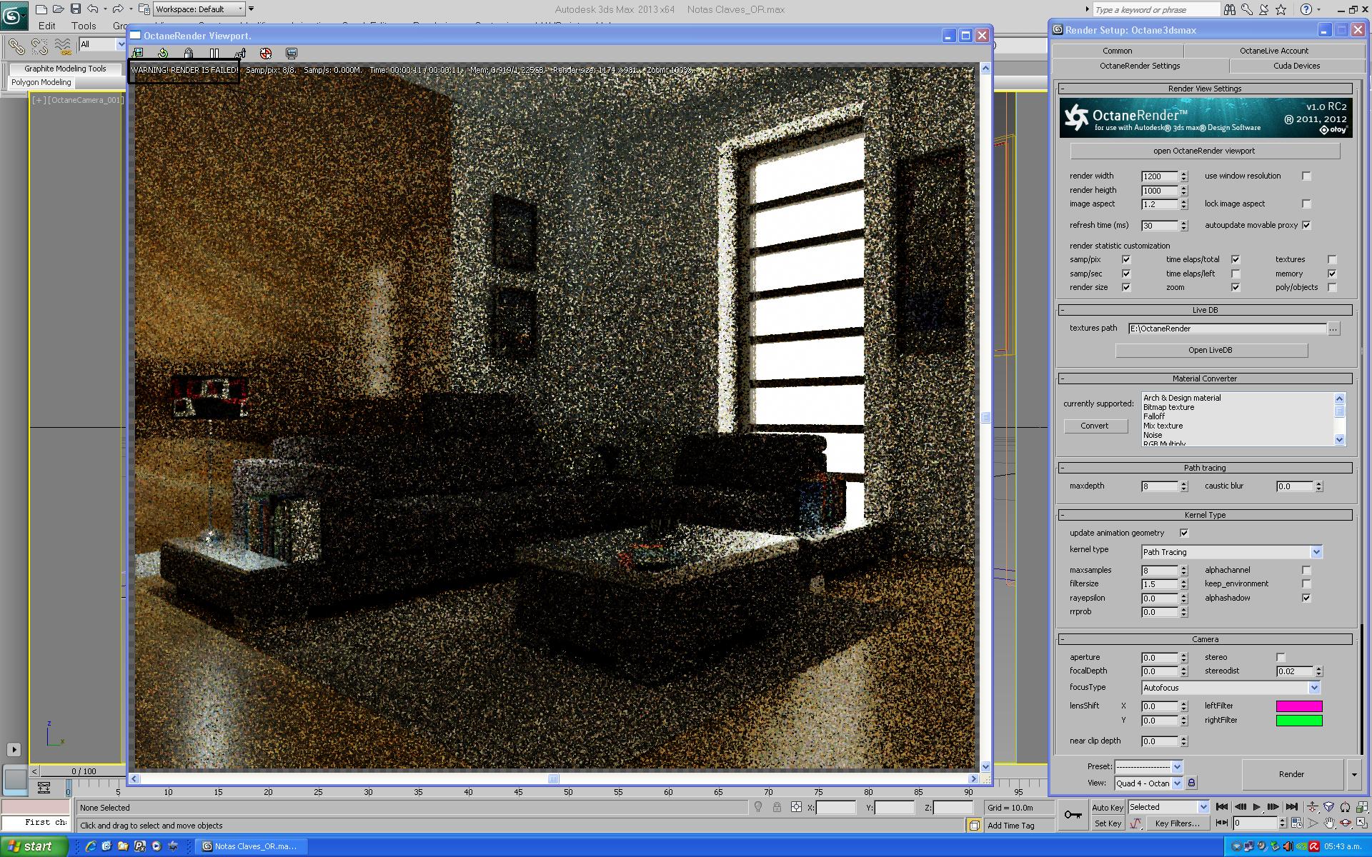

AlexCom
Posts: 16
Joined: Wed May 16, 2012 10:35 am
Actually nothing... just the surface, as you can see in my screenshot.
Also, If I try to create a new octane material, be it diffuse, glossy etc, max crashes. If I open scenes with octane materials in them, max crashes if I try to generate a material preview.
Win 7 Ult | i7 2600k | 16gb RAM | GTX 690 | 3ds max + Octane
Karba
Posts: 2300
AlexCom wrote:Actually nothing... just the surface, as you can see in my screenshot.
Your version is not RC2.
Please update to RC2.
