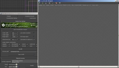

Yes, of course, with both, one on and one off, and vice versa.

AlexCom wrote:Yes, of course, with both, one on and one off, and vice versa.
Does octane standalone work on your GPU?
AlexCom
Posts: 16
Joined: Wed May 16, 2012 10:35 am
Yes, standalone works quite well, I tried it by importing one obj.
Win 7 Ult | i7 2600k | 16gb RAM | GTX 690 | 3ds max + Octane
Karba
Posts: 2300
AlexCom wrote:Yes, standalone works quite well, I tried it by importing one obj.
What do you see if you press "open octane viewport" button?
AlexCom
Posts: 16
Actually nothing... just the surface, as you can see in my screenshot.
Also, If I try to create a new octane material, be it diffuse, glossy etc, max crashes. If I open scenes with octane materials in them, max crashes if I try to generate a material preview.
Karba
Posts: 2300
AlexCom wrote:Actually nothing... just the surface, as you can see in my screenshot.
Your version is not RC2.
Please update to RC2.
AlexCom
Posts: 16
Hey Karba, thanks a lot... I did download it a few days ago.. but it did not work, I guess you updated it recently :) my browser downloaded it as a duplicate as well... but I still gave it a shot and now it works.. thanks again!
