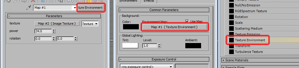

well I got used to the HDRI setup one from standalone, I am having trouble finding it each time..
how to rotate the HDRI and what is the correct workflow? I didn't check if there was anything in the manual..

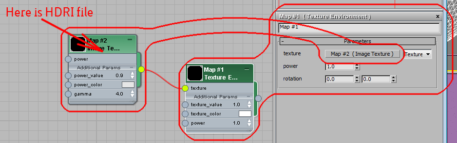

acc24ex wrote:well I got used to the HDRI setup one from standalone, I am having trouble finding it each time..
also I always save from the render viewport - and that doesn't save the alpha info into .png.. is that going to be stuck like that..
I mean I love the fact you can do a lot more with nodes and all in 3dmax, but then switching to standalone gets me working faster, only thing is as soon as I start to use nodes in standalone I switch back to max :) ..
Do you use this texture?
If so, what is wrong with it?
It is the same as standalone one.

ok I use this
I use Rendering > environments, set texture environment, and then drag and drop that to the map and load hdri from that..
i forgot the workflow as soon as I tried it.. i have to write it down :)

acc24ex wrote:
ok I use this
how else do you load the hdri into that
