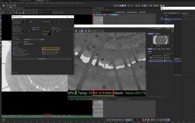

My render instances don't seem to be working at render time. When I send my scene to the live viewer I get 50 mil polys and a frame renders in about 3 minutes. No problem there. But when I send to the picture viewer my polys go up to 99 mil and the render times skyrockets to over an hour.
Any ideas? Attaching the scene here.
C4D 2024.1, Octane 2023.1 Beta3 R4 (issue persists with 2023.1 R3 and post fog is rendering different)
PIT_v20.zip
(3.47 MiB) Downloaded 172 times

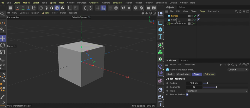

At the moment in C4D 2024.1.0, it looks like adding an Octane Object tag to an Octane Scatter source/surface object set to Surface distribution—not Vertex—results in a crash. See attached gif.
This issue does not occur in C4D 2023.2.

nycjunglist wrote:At the moment in C4D 2024.1.0, it looks like adding an Octane Object tag to an Octane Scatter source/surface object set to Surface distribution—not Vertex—results in a crash. See attached gif.
I'm checking it, source object having zero triangles when a tag droped over for a moment. I think it's related to performance changes of C4D 2024.

gohmn wrote:My render instances don't seem to be working at render time. When I send my scene to the live viewer I get 50 mil polys and a frame renders in about 3 minutes. No problem there. But when I send to the picture viewer my polys go up to 99 mil and the render times skyrockets to over an hour.
I've a bit reduced the clones for spikes for testing. As you can see here we have same amount of triangles in LV and PV. Be sure the option is checked in Octane Settings window. And having less triangles on spikes that would make your life easier.

gohmn
Posts: 15
Joined: Thu Oct 09, 2014 5:13 pm
Thanks Aoktar,
I did toggle that off and then back on again. Not sure if it helped but I did manage to start a render with the proper amount of polys. It seemed to be an intermittent issue without a discernable cause.
