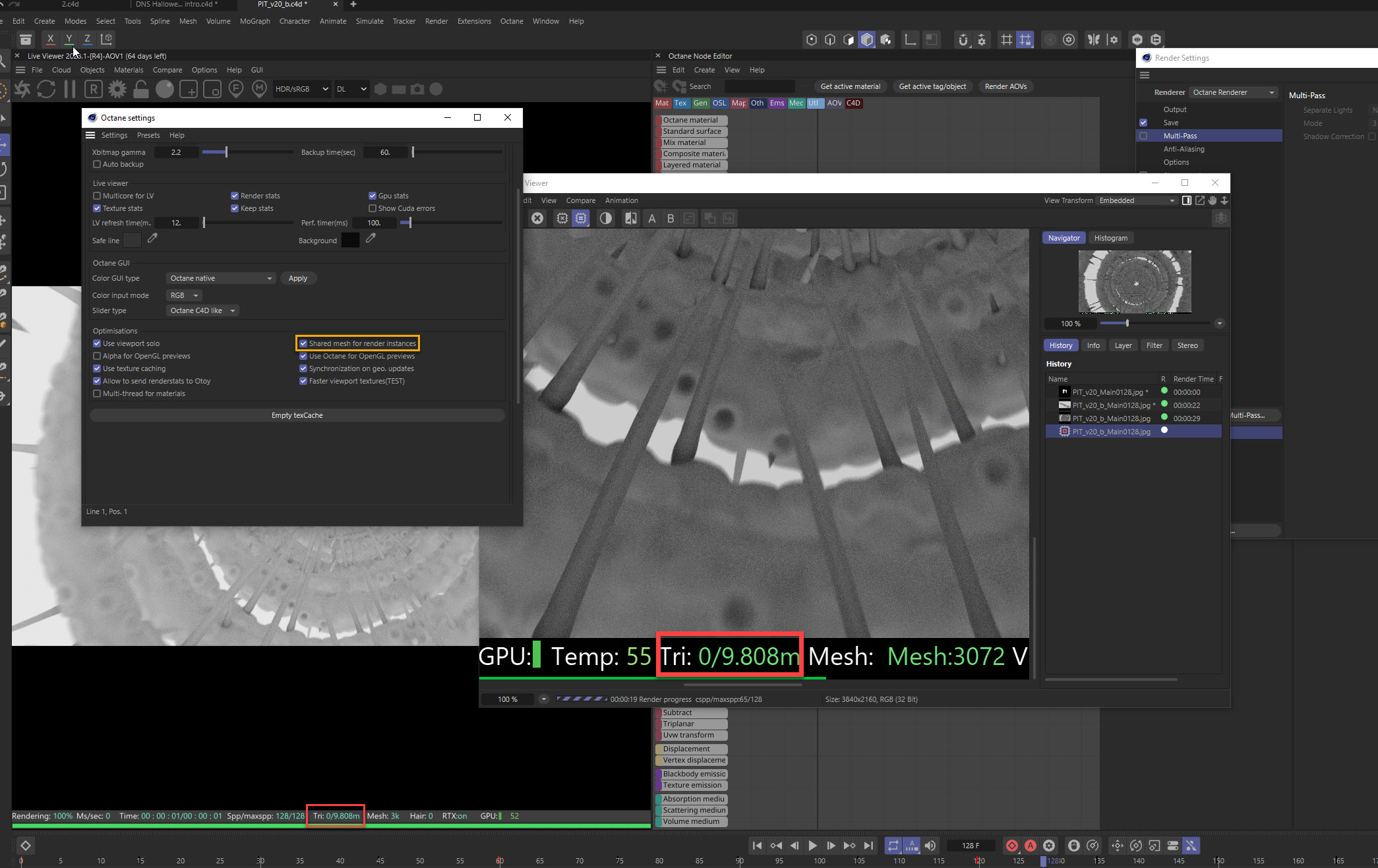

My render instances don't seem to be working at render time. When I send my scene to the live viewer I get 50 mil polys and a frame renders in about 3 minutes. No problem there. But when I send to the picture viewer my polys go up to 99 mil and the render times skyrockets to over an hour.
Any ideas? Attaching the scene here.

gohmn wrote:My render instances don't seem to be working at render time. When I send my scene to the live viewer I get 50 mil polys and a frame renders in about 3 minutes. No problem there. But when I send to the picture viewer my polys go up to 99 mil and the render times skyrockets to over an hour.
C4D 2024.1, Octane 2023.1 Beta3 R4 (issue persists with 2023.1 R3 and post fog is rendering different)
I've a bit reduced the clones for spikes for testing. As you can see here we have same amount of triangles in LV and PV. Be sure the option is checked in Octane Settings window. And having less triangles on spikes that would make your life easier.

thanulee wrote:Never noticed this option "Shared mesh for render instances"
Should be on by default? What it does exactly?
Yes ON by default. One shared mesh for original and copies. Otherwise we create two meshes in total
Thanks Aoktar,
I did toggle that off and then back on again. Not sure if it helped but I did manage to start a render with the proper amount of polys. It seemed to be an intermittent issue without a discernable cause.
