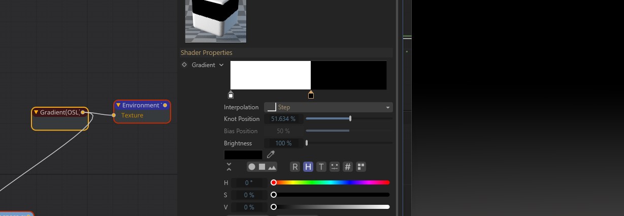

C4D baked gradient interpolation doesn't work
Gradients still have brightness issue using OCIO C4D color management.

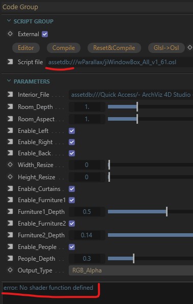

OSL is not visible if loaded from C4D Asset Browser :

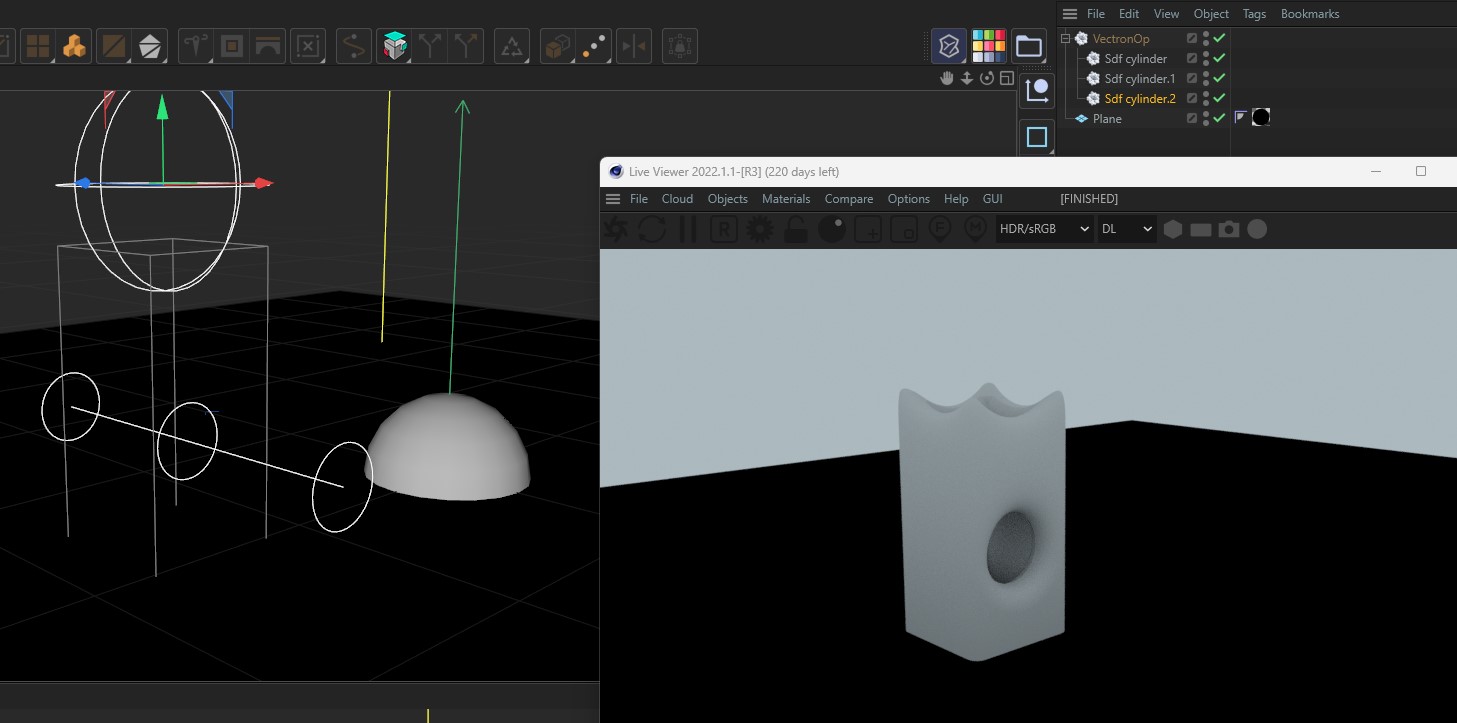

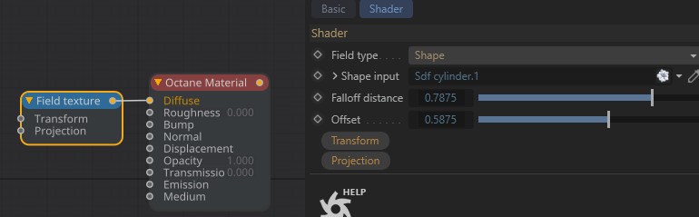

But Field Texture in Shape mode still doesn't work. I even can't get to work operators like intersect, substract between Sdf objects.
EDIT :
ok it works within VectronOP but I think it is little buggy because of wrong hierarchical dependencies. Please see, upper sphere should be united not subscracted :
I don't know how hierarchy dependencies works in Standalone but here the main problem is that it support only straight one without more complex boolean hierarchies inside main hierarchy.
Also please see that Field Texture doesn't work.
C4D freeze after deleting VectronOP

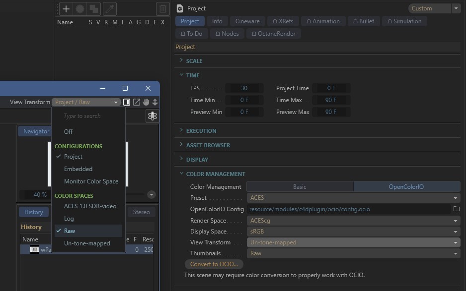

I'm noticing when I change over to Aces Tone mapping.
I'm unable to change gamma values?
Is this a bug and need fixing?
Also if want to render out my aces tone mapped version just a straight 16bit Png. No AOVs or anything. What do I need to set in the render setting to get the same look as the live viewer?

gifmotion wrote:I'm noticing when I change over to Aces Tone mapping.
Dean
ACES disable gamma and highlight compensation. To make it looks the same in C4D viewer you must change color settings in Project and Viewer :
But take in mind that all gradient nodes will produce different colors after that.
Aoktar - this is why people sometimes wants to use C4D OCIO.

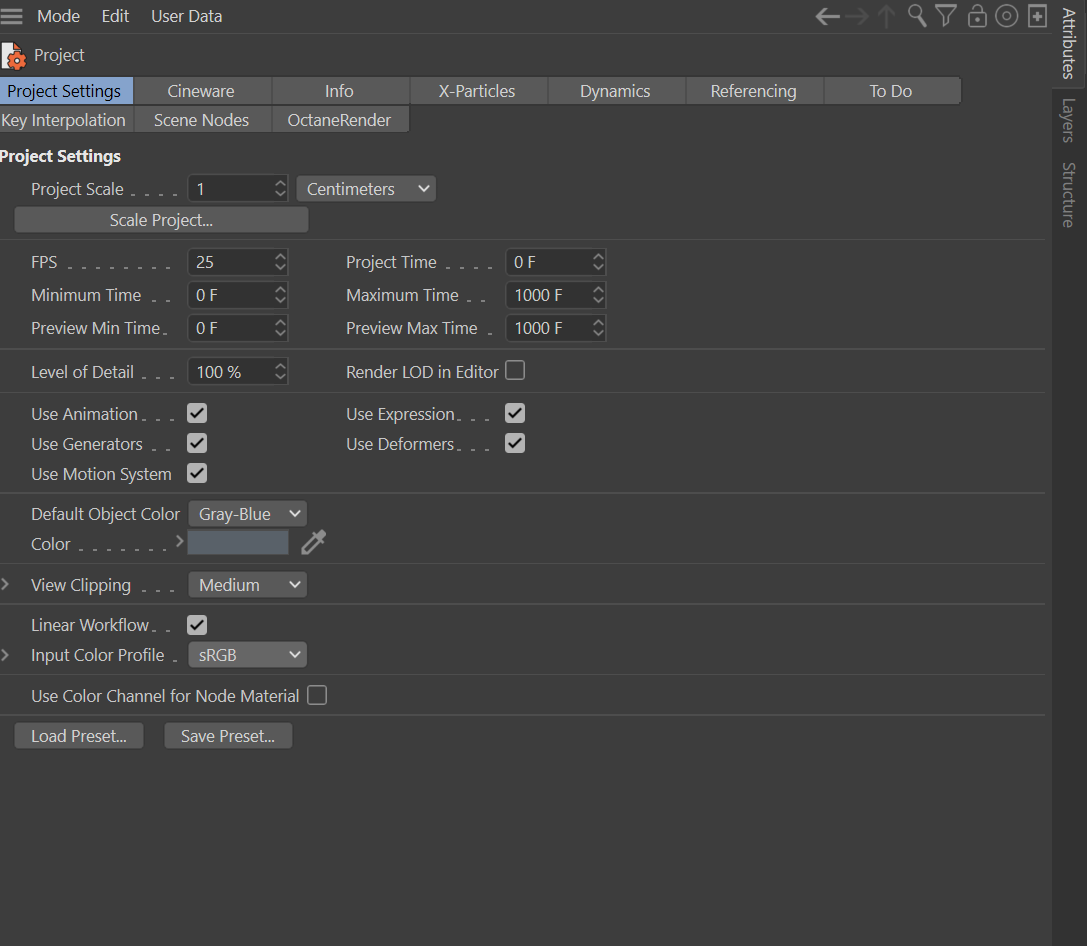

SSmolak - why is it that I can see the color management in my Cinema4D R25 or 2023? Can you be more specific to where I can find it in the Project and Viewer?
