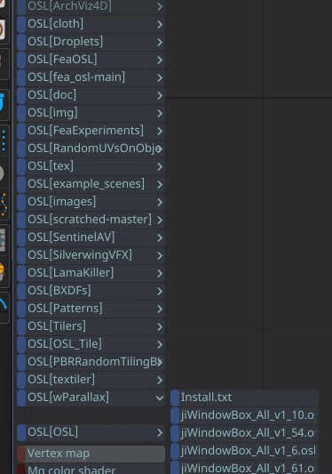

OSL scripts doesn't compile at all when custom OSL folder is used ( from settings - paths - OSL script location ).
Dragging custom OSLs from this new custom OSL menu do nothing :
Also "include OSL folders" from paths seems to not work too.
