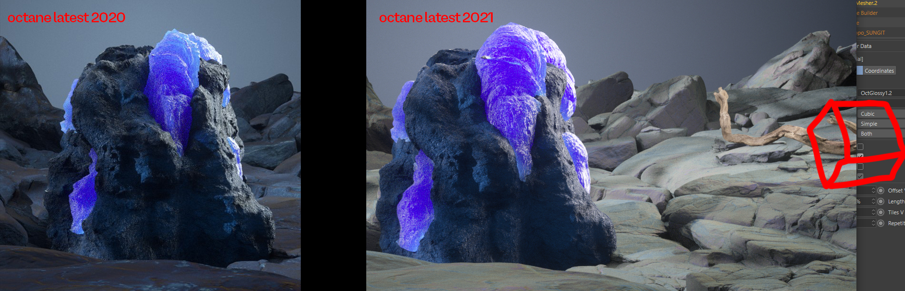

Im still not sure if im missing something simple, but wasnt box projection sticking on surface in 2020, and now its "floating" like camera/perspective mapping? Im loosing my mind here.
Posts: 16068
Location: Türkiye
IImk wrote:Im still not sure if im missing something simple, but wasnt box projection sticking on surface in 2020, and now its "floating" like camera/perspective mapping? Im loosing my mind here.
Nope, it will float if you're using Octane box projection with deformed meshes.

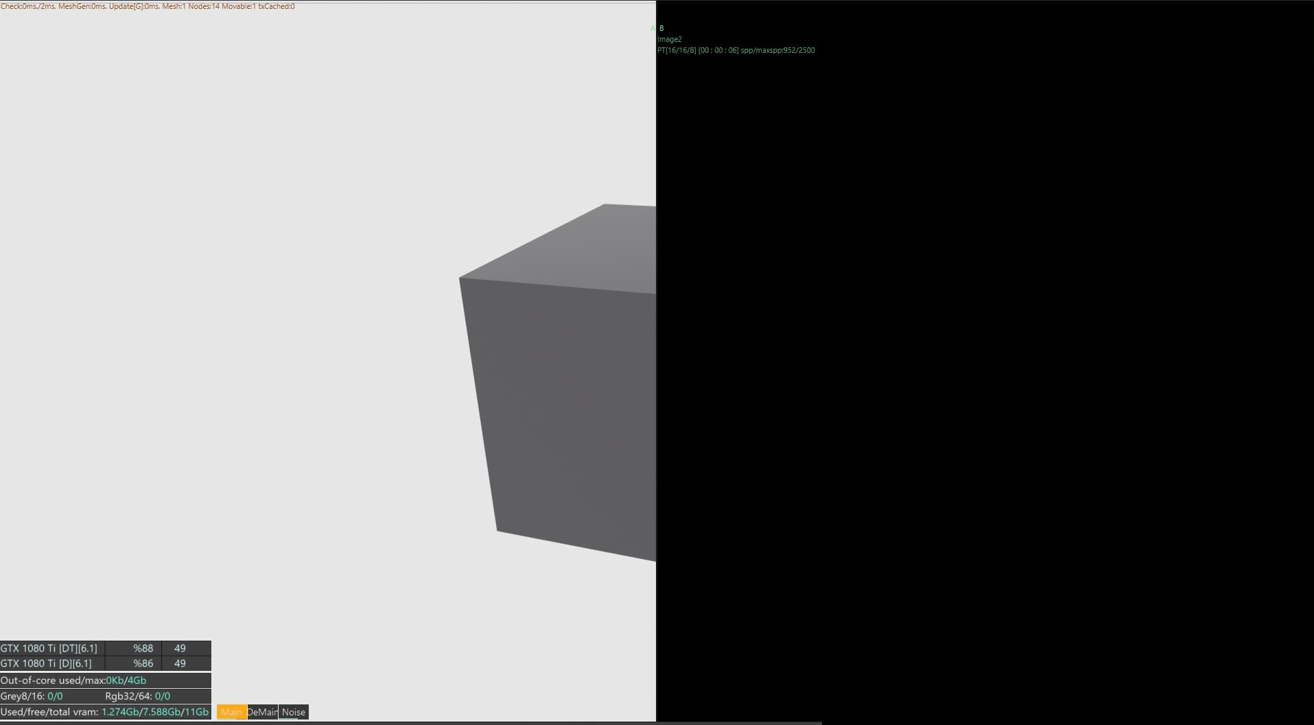

Store Render Buffer generate black preview if AI up-sampling is turned on.
Is this 2021 change irreversible? I made a pic related comparison on my old project with 2020 and 2021 octane plugin, and in 2020 box or cubic displacement mapping worked, and texture sticked to surface (didnt float). For someone as me, who avoids UVs unwrapping like death, this is a huge deal breaker with box/cubic mapping not working. Is it possible to have it fixed please?
Posts: 16068
Location: Türkiye
IImk wrote:
There's not any change on my side to cause this. Please share the object setup in a scene.
IImk
Posts: 14
Joined: Fri Aug 16, 2019 8:16 pm
aoktar wrote:Please share the object setup in a scene.
Sure, im posting link.
As i said my main issue is box projection texture "floating" in every project with 2021 plugin, when object is animated or moving. And displacement not working on box projection. In 2020 box projected displacement worked fine.
https://we.tl/t-6ekjJNDOZv

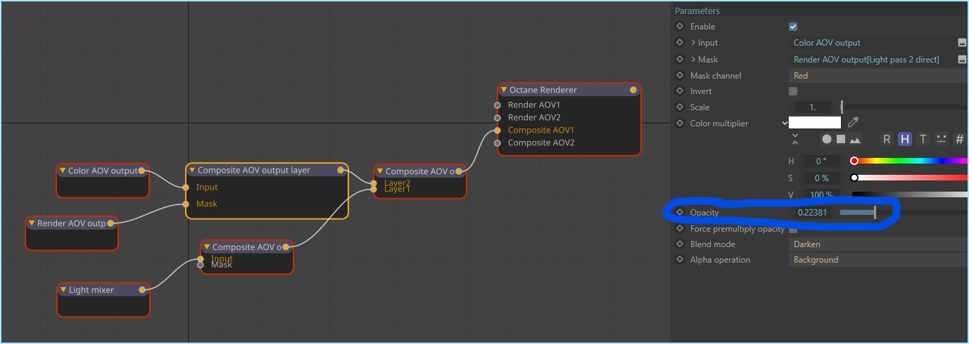

Alpha for OpenGL Previews doesn't work. I have turned on Alpha Channel and OGL previews in LV but no opacity in viewports at all.
Composite AOV layer opacity masking doesn't work if mask is connected to Light Pass
light_shadow_comp.zip
(92.25 KiB) Downloaded 173 times
Architectural Visualizations http://www.archviz-4d.studio
Posts: 16068
Location: Türkiye
SSmolak wrote:Alpha for OpenGL Previews doesn't work. I have turned on Alpha Channel and OGL previews in LV but no opacity in viewports at all.
A. For OGL works but not as expected. Nothing to do more, not a way to impreve it more. It's an option if helps a bit.
Other one is known issue and fixed before you for next release

Hi
I also get a black live viewer image when I enable 'store render buffer'.
Running C4D R26.015 with latest Nvidia driver 512.96.
Any idea what can cause this?
Thanks!
