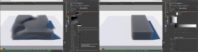

bepeg4d wrote:
Diffuse Transmission on the left, Specular Transmission on the right.
ciao,
Beppe
But the right one is much more realistic...

SSmolak wrote:
ciao,
Beppe
I agree 100%

@SSmolak & dynaraton:
probably yes, but depends on the type of grass you need to mimic, and if it is wet or not.
Anyway, the original question was why Universal material with Albedo+Transmission was different from a Mix between Diffuse+Transmission and Glossy ;)

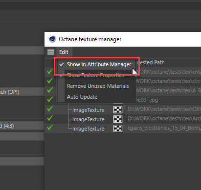

Hi, Aoktar
The Octane texture manager is really great! I use it often to check texture use and to optimize nodes.
2 Issues:
1. Is there a way to locate the shader/material where a particular texture from the list is from?
2. BUG: If the Octane Texture Manager window is open and I delete a shader/material from the material manager, C4D freezes.

Kalua wrote:Hi, Aoktar
2 Issues:
Regards,
Try auto update to avoid crashes. But it may slow down you much.
2 Issues:
Regards,
1. Thank you!!
2. Still causes issues. I suppose is better to close the Octane texture manager window before deleting any shader.
Regards,

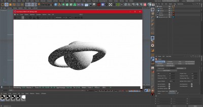

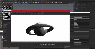

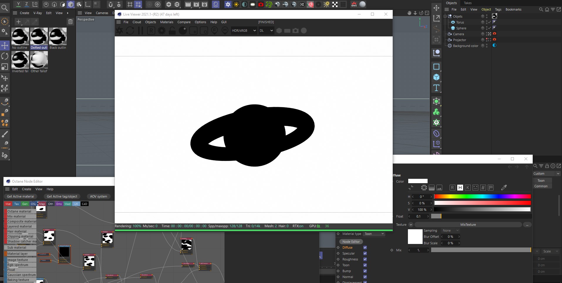

Does anybody knows what changed with Toonshade?
I used to see a toonshade with no toon lighting, only environment on 2020.2.
Now the scene requieres toon lights and casts unwanted shadows.
What should I do to keep the same effect as before?
Regards,
Toon shaders set on 2021.1-R2 as 2020.2
Toon shaders require now toon light on 2021.1-R2 and projects shadows
Toon shaders work great on 2020.2.5-R3
C4D 2025.3.3 Octane v1.9.4 // Octane SA 2026.4, Windows 11 Pro, X399, AMD TR 2950X, <<2 X 3090 + NVlink>>, 128 GB RAM, Corsair 1500i - NVIDIA SD 610.62
Octane User since V1 Beta
