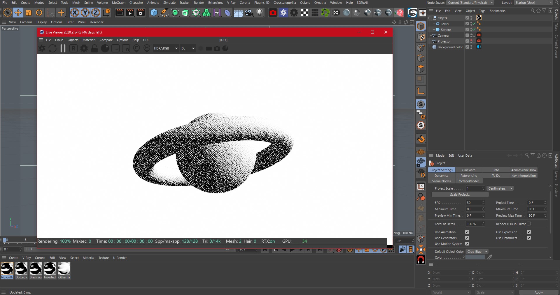

Does anybody knows what changed with Toonshade?
I used to see a toonshade with no toon lighting, only environment on 2020.2.
Now the scene requieres toon lights and casts unwanted shadows.
What should I do to keep the same effect as before?
Regards,
Regards,

Which kind of result are you trying to achieve using the Toon Material?Kalua wrote:Does anybody knows what changed with Toonshade?
Regards,
Some changes have been made to the way it works, and those are actually very good ones.
If you need to get the previous result with no Lights in the scene, just set the Toon Lighting Mode to Camera Light and you'll get the same result we see in 2020.5, no light needed.
You may also need to tweak the Toon Shadow Ambient Light (set it to perfect white if you need "constant" shading) when using this lighting mode.
Also, if you use a Toon Light (which is a very good practice, by the way), you can disable Cast Shadows if you only need shading with no shadows.
If you need any help with a specific look you need to achieve, please just ask.
Thank you, Linolinograndiotoy wrote:Which kind of result are you trying to achieve using the Toon Material?Kalua wrote:Does anybody knows what changed with Toonshade?
Regards,
That did the trick. I was sure it was a matter of finding the new parameters that caused the difference along versions.
Regards,
PS.: Lino: how do you disable shadows in toon lights? Can't seem to find the parameter.
