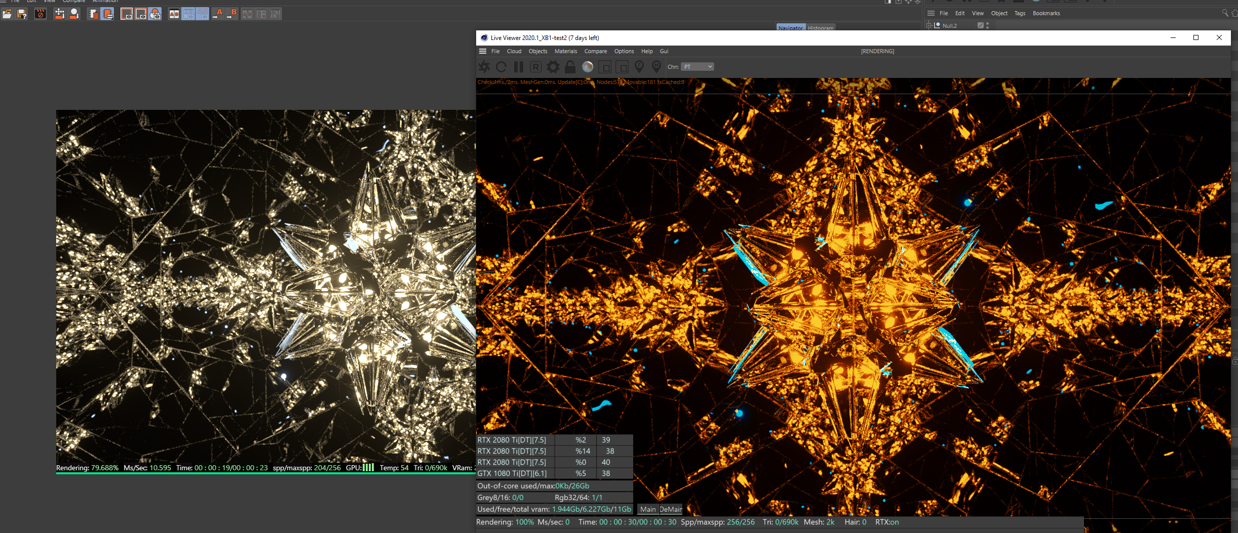

Hi Ahmet,
Thoroughly enjoying the great speed improvements with RTX!!! Great work
I have noticed that not all changes to the camera imager are not being rendered out. Specifically, saturation and lut strength. It works in the live viewer but not in the final render unless I'm missing something.
I have attached an image illustrating the difference.
I'm rendering with the following settings
Camera tag:
- Response: Linear
- Neutral response checked
- Gamma:2.2
Render Pass Settings
Image colour profile: Linear
Tonemap type: Linear
Render Buffer tyoe: Float (linear)

This is not a new behavior on this version.
LV is using tonemapped render buffers. In PV with your current settings you're using raw output.
